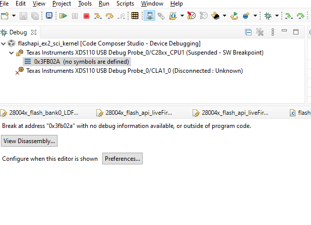

    I tried below scenario but it dint work out:
    1. Made changes to 28004x_flash_api_liveFirmwareUpdate_bank0_lnk.cmd file not to overlap with SCI kernel RAM. I dint change anything in Kernel cmd file.    please find attached below 28004x_flash_api_liveFirmwareUpdate_bank0_lnk.cmd file changes done for your reference below.

    2. Changes made in function ldfuCopyData() of flashapi_ex2_ldfu.c to make sure kernel erases sectors 8- 15 and programs it with application image.                   flashed SCI kernel for BANK0_LDFU_ROM config and then using serial flash programmer i did LDFU for application using BANK0_ROM config, i was             able to do LFU but i got below error while running  the application. I Felt atleast for the very first time kernel should have been able to erase and program         the application and able to run but it dint work out.
    suhailpasha.b@ltts.com is my mail id, please suggest to proceed further
