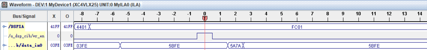

Hi all, I got a very weird issue on 28335 xintf interface right now.  In my board, I connected low data bus(bit15~0) xintf pins to a fpga, and I configured xintf to 16 bit bus mode.  The issue is that when dsp write data to fpga,the data on bus is not the same as dsp writed,you see this in picture one, but read operation is ok.

the test code is shown as below:
Uint16    *ExRamStart = (Uint16 *)0x200000;
*(ExRamStart + 1) = 0x5a5a;
*(ExRamStart + 2) = 0x1234;
*(ExRamStart + 3) = 0xa5a5;
Some bits of the data is not correct, this really confuse me.
By the way, I'm using zone7 for fpga memory space, and all dsp read function works good.
Does any TI experts or other experts can help me?  Thanks in advance.

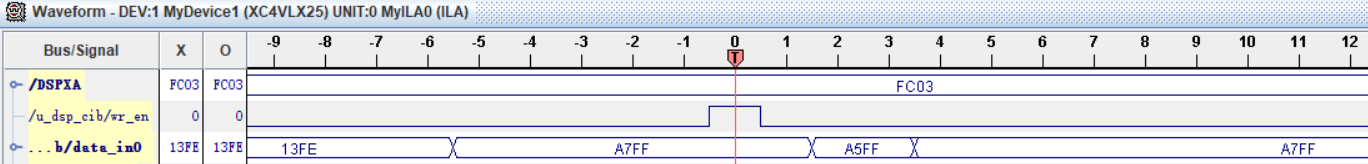

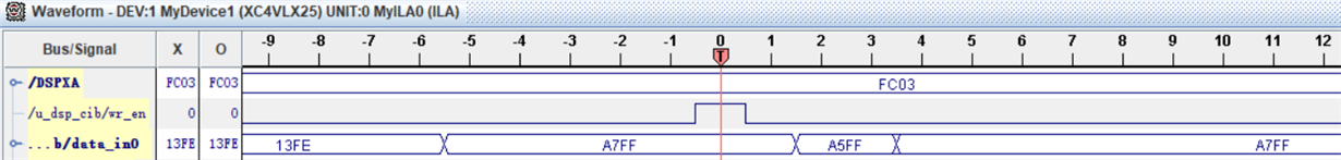

  • Hi Karthik,
        Thanks for your reply,there are some new situations:
    1. When the initialization finished, before the dsp didn't write no data to the space, but the address 0x20000~0x200fff has filled with datas such as 0x3ff, 0x8bf etc,where did these data come from ?
    2. When dsp write data to the address use  *(0x201100) = 0x5a5a,the low 10bits is all 1,that means the data is 0x5dff; But when i write 0x5a5a in memory at the same address, the data on bus is correct.
      Fanghao.
    How are you able to determine that reads are working?
    If the locations have not been written to, the contents are invalid, uninitialized values.  In the case where you are interfacing with an FPGA, it is determined by the FPGA.
    Please clarify how you perform write 0x5a5a in memory at the same address and how this is different from *(0x201100) = 0x5a5a.  When you say that all lower 10-bits are 1, are you observing the voltage with an oscilloscope?  This would be the preferred method because it can show you if there is contention on the bus.
