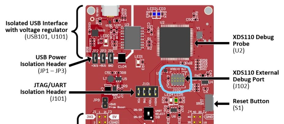

Since, I am using an onboard XDS110 USB debug probe that comes with the F280049C Launchpad, that has only 10 pins, I am using a 10 pin to 14 pin connector for the JTAG as per the table given below.
I am attaching a photo of the onboard XDS 110 in the F280049C Launchpad that I have used. I have removed the jumpers present in J101 as well while connecting to an external target.
I would much appreciate it if someone can give me a solution for the aforementioned problem.
Thanks in advance.

  • Preetham,
    I'm including the link to J102 on the LAUNCHXL-F280049C for reference page 5.
    The 10-14 pin connection is correct, however, the J102 connector does not bring out the EMU0/EMU1 signals that are used on the F2802 device.
    I think we can connect without them, but you will need to tie them off at the 14 pin header with EMU0 grounded and EMU1 pulled to VDDIO(3.3V).  This will put the device in Wait In Reset mode, which will wait for the JTAG connection to release the internal reset strobe.
    There will be some analysis features you won't have access to, but all normal debug functions should work.
    Let me know if this allows you to connect.
    Matthew

  • Preetham,
    EMU0/1  high/high is fine as well for normal operation; but in this case I wanted to try and see if activating the WIR mode helped us connect(which it didn't).  Can you advise on the connection you have from the in terms of the physical 10 pin header on the LAUNCHXL-F280049(not the generic 10-pin to 14-pin) to the 14-pin header you created.
    Matthew

  • Preetham,
    Based on the 14 pin JTAG signals here's what the mapping should be:
    J102 14-pin JTAG
    Pin 1 3.3V
    Pin 5 VCCS
    Pin 2 TMS
    Pin 1 TMS
    Pins 3/5/9 GND
    Pins 4/8/10/12 GND
    Pin 4 TCK
    Pins 9/11 TCK/RTCK
    Pin 6 TDO Pin 7 TDO
    Pin 8 TDI Pin 3 TDI
    Pin 10 TRSTn Pin 2 TRSTn
    Pins 13/14 tie off manually
    Matthew
