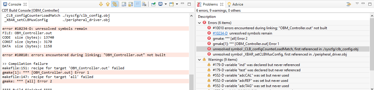

I then took an existing code that we are running on our eval board, which has compiled without any issue thus far, and followed the same procedure to add a syscfg file to that project. I made sure all of the Path Variables in the Linked Resources matched the working example, and I hit build.  I ended up getting this error:
I am not sure why this would be happening, since I have all of the same libraries linked to this project as the working example, so I am not sure where to start looking.  Can anyone tell me what I should be looking for?
  • Hello Anthony,
    The function CLB_configCounterLoadMatch is part of driverlib.  If you check the properties of the project (right click on the project --> properties) under C2000 Linker, File Search Path, do you see driverlib.lib under "Include library"? Also check under --search_path for an appropriate directory.  driverlib is under C2000Ware

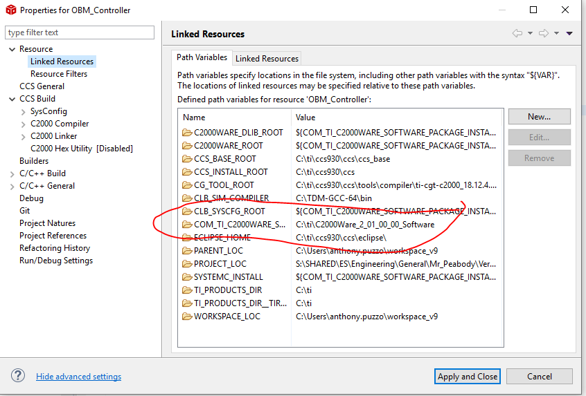

  • So the CLB TILEs (and the code that sets them up) are almost exactly the same in the working example and the project I am working on. This is why I am confused.
    I used the same FSM's, counters, HLC's, etc configured in the exact same way for both. The only difference is the inputs I am using to the TILEs (for example, I am using CMPSS1, 3, 3, and 4 in the real project, and CMPSS 2, 4, and 6 in the working file as the inputs to the tiles through the XBAR).
    One major thing I also noticed between the working example and the real project is that the html file for the CLB was not generated in the project but was generated in the working example... could this be a clue?

  • I have downloaded the latest C2000Ware 3.03.00, but I am not sure what to do next. It looks like there are several things I would need to change in the properties, but I am not 100% sure what those things are.
  • I tried changing it in this tab of the GUI, but it keeps reverting back to version 2 for some reason:

  • Hi Lori,
    I think I found the issue. Whoever the original author of the code I am working on was, they must have built it with a much older version of the software.
    All of the links you told me to look at checked out, and yet I was still getting the error. I ended up doing a deeper dive into the driverlib folder and the device.c and driverlib.h files under the device folder, shown here:
    I compared the files in my project to those of the example project that works, and found that there are no clb.h or clb.h files in my project, and there is no mention of the CLB in the xbar.h, cbar.c, files. I opened the example project versions of these codes, and right away I noticed a difference: the example project was using the support library version 1.08.00.00, while my project was using version 1.05.00.00.
    I ended up copying the entire driverlib folder as well as device.c and driverlib.h (not device.c, since that one had no mention of the CLB) from the example project to my project, and I was finally able to build the project with 0 errors. This appears to have resolved my issue.
