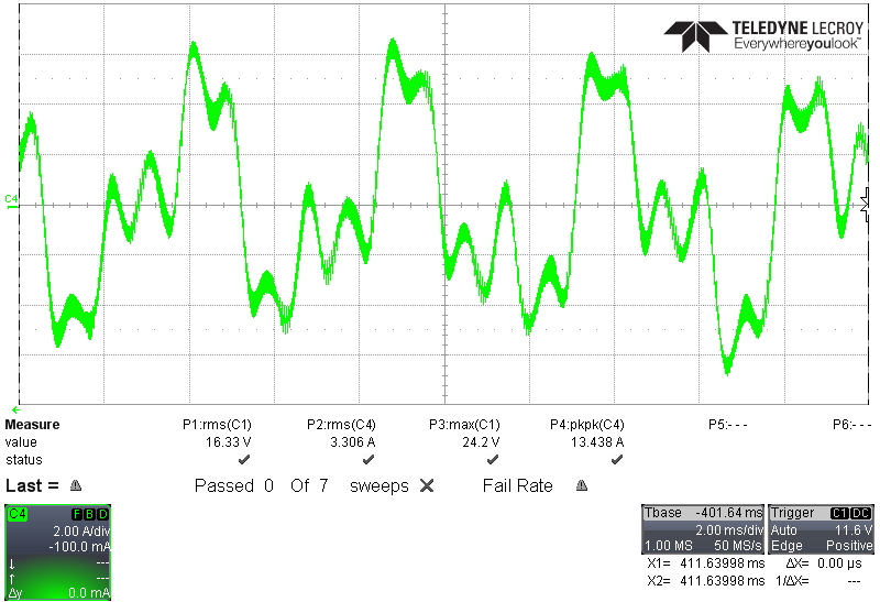

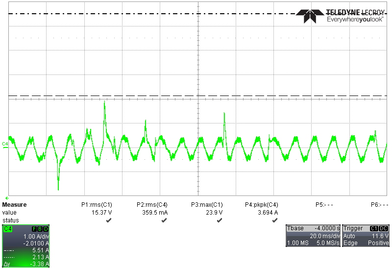

  • Managed to beg, borrow and steel the scope with current probe and here are some results,
    definitely not looking as if everything is correct.
    This is current over one of the phases.
    Strange 'peaks' at lower rpm, totally weird at higher rpm, no wonder the over current protection trips.
    What should be our next step?
    Is this a current measurement problem? Too coars current scale making FAST to fail?
    Or the current/torque PID oscillating?
  • It seems like it's really over current and the motor didn't run well. You might try to increase the dc bus voltage to see what happens.
