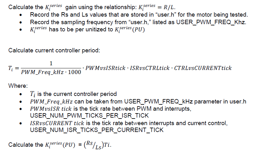

Could you please explain this discrepancy between the Lab guide and the Lab Code? Am I missing something here in the calculation?

1.InstaSPIN-FOC doesn't support inertia identification.
2. Not need to be PU format in MotorControlSDK, just use the equations at the end of this section, Ki = (R/L)*Ti, Kp=Ls*2*PI()/Ti. Sorry for confusing you, we will correct this, thanks.

Thanks for clearing up the confusion. There is some discrepancies in the InstaSPIN-FOC Lab guide and User's Guide in the Speed Controller Tuning.
In the Lab 07, it is mentioned that "InstaSPIN uses a series PI loop for the current controllers and a parallel PI loop for the speed controller." However, InstaSPIN-FOC User's Guide mentioned that "it uses series PI loop for both the Speed and Current controller. "
Could you provide me best references of these equations of controller (Speed and Current) gain calculation? Which is consistent with the code provided in the MotorControl SDK for LAUNCHXL-F280049C and BOOSTXL-DRV8320RS.

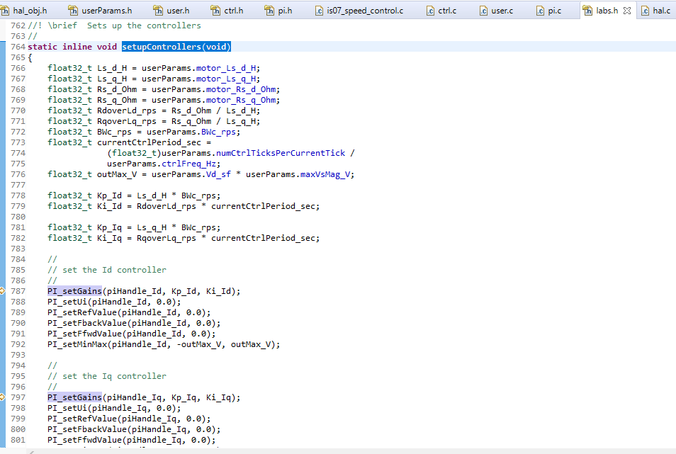

I am comparing InstaSPIN-FOC User's guide (Chapter 11) with the example code to make sense of the concepts in the guide and actual implementation of it in the code.
From the equations that you mentioned , only Ki seems to be the same equations in the code and in the guide and it kind of make sense that you have to digitize PI values based on the sampling rate (Ti).
However, the Kp equation you mentioned is totally different form the code and user's guide. You can see in the above image, that Kp_iq equation matches the concept in user's guide.
Could you clarify this? Even if we want to digitize this value, it needs to be multiplied by sampling rate (Ti) as in Ki value. Is it correct or I am missing something here?
