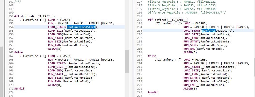

Both projects are set as Active Flash, and I have the following cmd commands:
I think I am missing something. Do you have an example of standalone then loading to RAM I can check?
