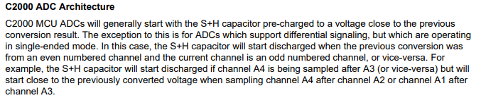

    Are the signals that are affecting each other sampled sequentially?  You may want to have a look at the description of "Memory Cross-Talk" in the following application note:

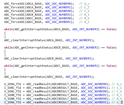

  • I am facing the same problem. I adapted it to my code by following the application note you suggested, but there was no change. When I sent the data to my computer via SCI, I got the following results.

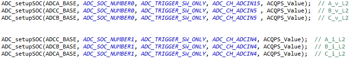

    The sampling order in my code is as follows:
    It tells us not to use single or double channels consecutively in the document you suggested. I applied it as stated in the document:

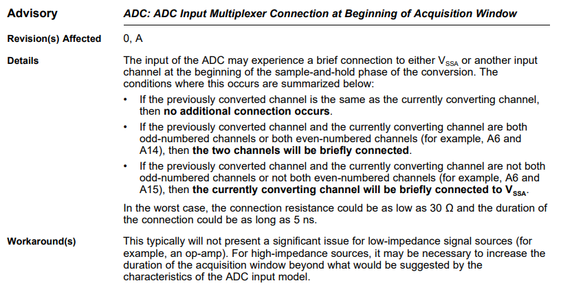

    In addition, while investigating this situation, I encountered a situation like this in erratashet:
    But this error is only degraded to channel A, for my situation, I have encountered with same problems on other chanelles, ie. A, B,C Channels. Now, I am investigating reason of this problem in the reference manuel.

    I'm not sure what you mean by "It tells us not to use single or double channels consecutively". There is no restriction or recommendation against any particular sequence of channel sampling. The section you quoted describes what type of errors you will likely see if (and only if) the input settling design is not correct.
    This erratum is unlikely to apply to your device, as it only applies to device revisions 0 and A, while production released devices are on revision C. It is maybe possible that you have revision A silicon if you have a very old launchpad.  You can use the device errata to determine how to read the markings on the device, or you can read the REVID register on the device.

    As designed, your SW triggering method will result in asynchronous operation between the ADCs (see "ensuring synchronous operation" section of the TRM).  This has some performance impactions for the ADC (see "ADC-to-ADC Isolation" and "ENOB" specifications in the datasheet).
    If you intend to SW trigger your ADC results, you should follow the parallel SW trigger example in c2000ware to ensure all your ADCs start converting simultaneously.  Otherwise, using the ePWM to trigger the results should also prevent this issue.
