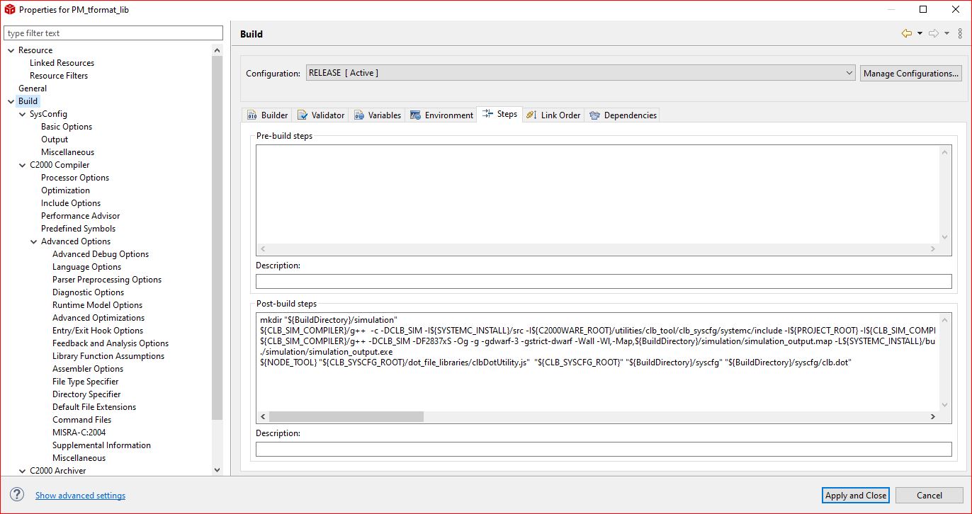

This is your problem. The variable is not defined:
Morgan/workspace_v11/PM_tformat_lib/RELEASE/simulation/clb_sim.d
This is not correct.
Take a screenshot of Build -> Post Build steps.
Here is a possibility:
I noticed that the G++ compiler has broken my user name in two- it is Don Morgan, that is Don(space)Morgan.
sometimes it appears to search for a Don directory and sometimes a Morgan directory. Of course, neither exist, so it can't find them, etc.
Is there a work around? Does the workspace need to be in the Users directory?
Don
It seems like things are compiling and your paths are correct. Did you get the VCD file?
If the VCD file is not created:
Are you using THE SPECIFIC version o the TDM compiler mentioned in the User guide? If using the latest version or any other version you will get a BUILD error from the TDM compiler.
It seems like now all of your paths are going through successully and your the only issue could be your TDM compiler?
Nima
