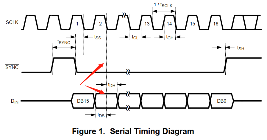

I have a problem with the DAC108S085. The instruction manual said that the min value of tss is 3-10 ns, and the max value is (1/fSCLK - 3). I use TMS320F280049 to connect this DAC modular, but it's output parameter of tss cannot meet the requirement of the DAC chip.
The output of the tms320f280049 is show below.
SCLK = 1MHz
according to the manual of DAC108S085:
max tss = 997ns
max tsh = 997ns
But in fact the output of TMS320F280049 is
tss = 2000ns
tsh = 480ns
the tss value cannot meet the requirement of DAC
I try to configure the output of the DSP, but I cannot find the way to configure this parameter of DSP
In the DAC datasheet, I see that "Once SYNC is low, the data on the DIN line is clocked into the 16-bit serial input register on the falling edges of SCLK". Looking at the snapshot you shared, it looks like the SPICLK is configured with Polarity = 0, in which the data is transmitted on the rising edge of SPICLK.
Can you change the polarity and try?

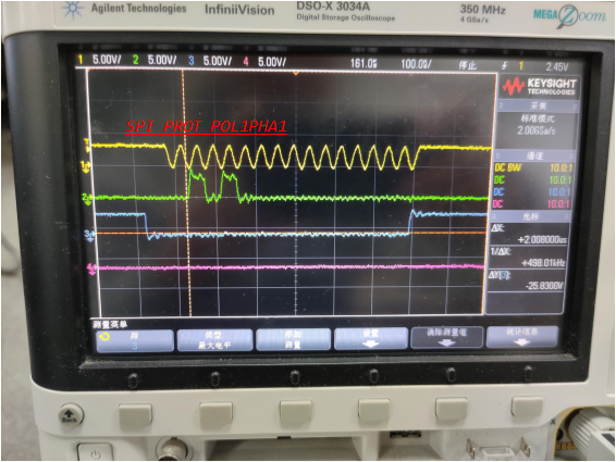

Hi Veena,
What you said is right, the picture i send is configure as rising edge of SPICLK, by configuring as 'SPI_PROT_POL0PHA0'
I have try what you said by configuring as 'SPI_PROT_POL0PHA1', but the DAC still cannot be configure right.
Best regards.
kevin
the code is show below.

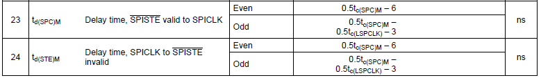

Hi Kevin,
I am sorry, I was looking at an older version of the datasheet. As per the updated datasheet, for 1MHz clock, the STE active SCLK will be ~1400ns.
Can you increase the SPICLK frequency and try?

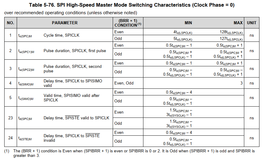

Hi Veena,
I'm trying to increased the SPICLK frequency, but it seem that I should configure DSP as high-speed mode to increase the speed.
I use the C2000 ware lib to program, can you tell me how to configure it as high-speed mode?
Best regards
Kevin

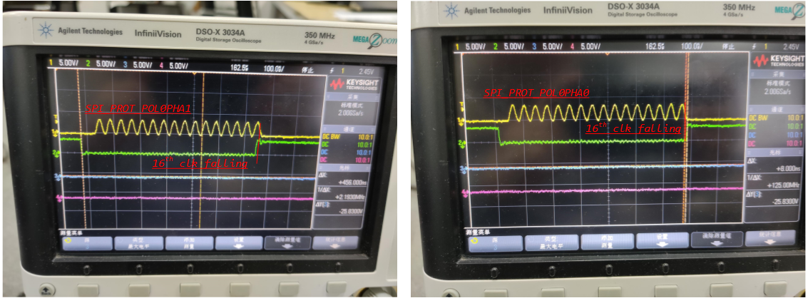

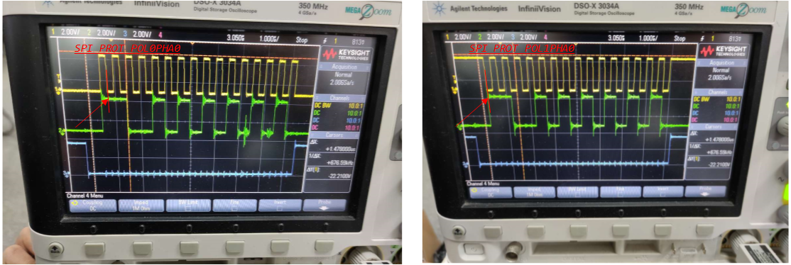

Hi Veena,
I success to configure the DAC chip, by setting as ' SPI_PROT_POL0PHA0'.
What i confuss is that, in this mode, it mean ' Rising edge without delay' for DSP, by the graph i catch seem to be 'Falling edge without delay'.
You can see the difference of SPI_PROT_POL0PHA0 and SPI_PROT_POL1PHA0 in the picture below.
Is it normal?
Best regards
Kevin
Hi Kevin,
With polarity=0, data will be output on the rising edge of the SPICLK and with polarity=1, data will be output on the falling edge of the SPICLK.
I am seeing the same behavior in the snapshot you shared.
Veena
