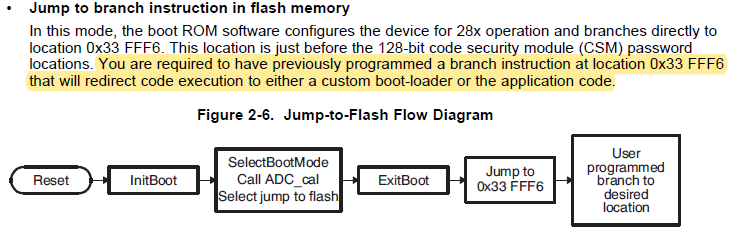

    Next, if you look at your DSP2833x_CodeStartBranch.asm file, you can see that the custom start section is aliased to codestart, whereas the standard C-initialization section is aliased to _c_int00:
    Your .MAP is pointing to _c_int00 in RAM as the entrypoint, which means that the program is bypassing DSP2833x_CodeStartBranch.asm:

  • Dear Tommy,
    Thank you for your valuable information. I have managed to make my program start from DSP2833x_CodeStartBranch.asm by adding -e"code_start" in the linker's argument in Simulink. I guessed, that it is just the same linker  with your approach called in the background, and it worked. I have also ticked the relevant "boot from flash (stand alone execution)" in the code generation tab, so the map file now looks like >>this<<.
     As you can see the new map file now has the whole package: ENTRY POINT SYMBOL: "code_start"  address: 0033fff6
    and then later on, as you have suggested:
    codestart
    * 0 0033fff6 00000002
    0033fff6 00000002 DSP2833x_CodeStartBranch.obj (codestart)

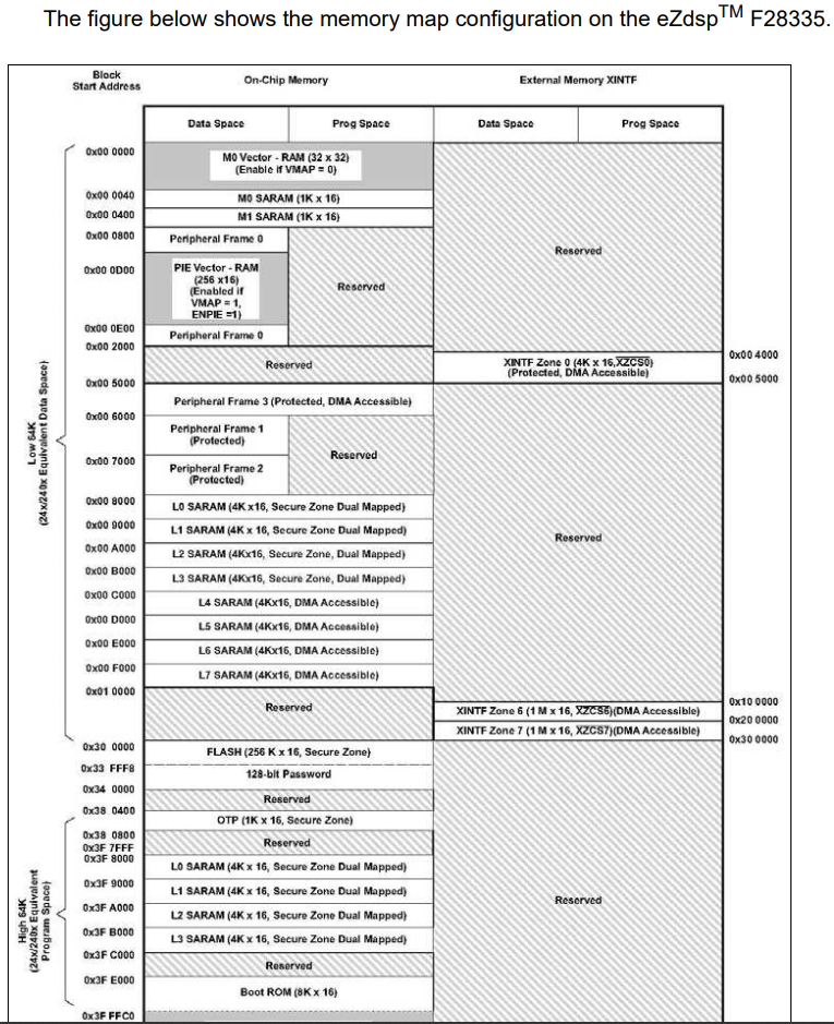

    The GEL file is only referring to the theoretical capabilities of the F2833x device. The real-world usage depends on how the device is configured and what components are connected to the device. I was working under the assumption that you have a memory correctly interfaced with F2833x using the Zone 6 CS.

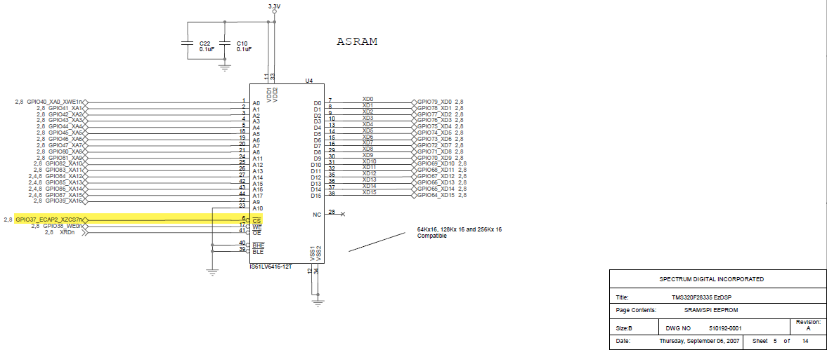

    The Spectrum Digital (third party) EzDSP board has a memory installed on Zone 7:

    The name of the section is arbitrary for human readability, however the address range determines which Zone the XINTF uses for external memory access:

    Yes, I have located the schematic about ASRAM and XZCS7n in my >>eZdsp F28335 technical reference<<. However, a few pages earlier (pp. 2-6) there is Figure 2-3 "eZdsp F28335 Memory Space" that, according to the text above it, shows the memory map configuration of the eZdsp F28335. As you can see, there is clearly Zone 6 at External Memory XINTF, just above the memory space of Zone 7:

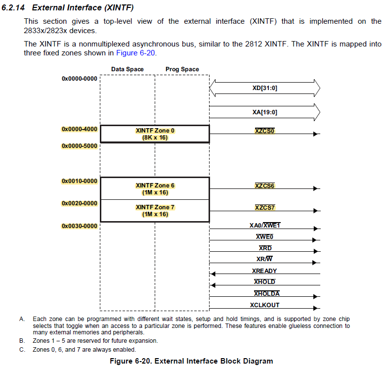

    Yes, this appears to be a direct copy/paste from the F2833x datasheet.

    In the previous page (2-5) that summarizes the eZdsp F28335 Memory specifications it clarifies that "... In addition 128K x 16 off-chip SRAM is provided", and in "Hardware Features" at the very beginning it says :"256K bytes off-chip SRAM memory" (whch translates to 128 X16).
    Yes, there is an off-chip memory component that is interfaced with XINTF.

    The F2833x Zone that is used to access the external memory is HARDWIRED based on the XZCSn SIGNAL MAPPING between the XINTF and external memory.  The memory is wired to XZCS7 in the schematic.

    The available memory space for both Zone6 and Zone7 is 1Mx16 each.  As you have pointed out, the external memory is only 128Kx16 so it takes up 1/8 of the Zone7 address range.

    ZONE7P:      origin=0x200000, length=0x1ffff
    2) This will allocate the full size of available external memory of my eZdsp F28355 to one memory block, sized 128Kx16=256Kbytes.
    3) In my InitExtMemIf.asm file I have to make sure that I set the appropriate GPIO-mux register values, so that chip-select pins for Zone7 are used for that purpose and not for digital input/output (i.e., XZCS7n).
    4) If all the above are done correctly, I can assign in my linker file my .ebss to ZONE7P, which can be 256K bytes of code long (if I do not add some other on-chip memory space to it).
    5) There is no other external memory chip on the eZdsp F28335, no Zone6, no Zone 0.
    I really appreciate your time,
    Panagis
  • Panagis,
    Yes, you have the correct understanding.
    There is some nuance for your last point regarding the eZdsp memory.  From the schematic:
    1. I see a note claiming that the memory component footprint and signal mapping is compatible with 256Kx16 memories so you can expand the storage by swapping out components
    2. I see that an EMIF expansion connector is defined on the board so that a custom daughtercard with additional memory can be plugged in
    -Tommy
