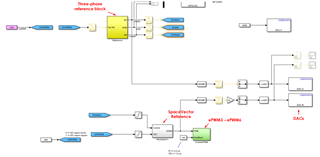

Hi, I am experiencing a curious issue. I am using MATLAB Simulink 2018a for creating and loading the application code. Application code consists of ADC blocks, sinusoidal reference, control, PWM reference and PWM blocks (standard three-phase inverter closed-loop control)

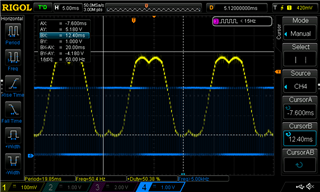

There are four different cases, each with different results I have trouble explaining. In each case I monitor two signals on DAC (DACOUTA and DACOUTB): Ch1 is a sinusoidal reference and Ch4 is a space vector PWM reference.
  1. I load application code (Build, Load, Run and Boot from Flash (stand-alone)). Ch1 is a sinusoidal reference (50 Hz) and Ch4 is a space vector PWM reference (50 Hz) -> expacted results
  2. Same application code, but now in an External Mode: Ch1 is a sinusoidal reference (50 Hz) and Ch4 also a sinusoidal reference (50 Hz).
  3. I remove most of the code and keep only a sinusoidal reference and PWM reference calculation (open-loop control). I load application code (Build, Load, Run and Boot from Flash (stand-alone)). Ch1 is a sinusoidal reference (100 Hz) and Ch4 is a space vector PWM reference (100 Hz).
  4. Same simplified application code, but now in an External Mode: Ch1 is a sinusoidal reference (100 Hz) and Ch4 also sinusoidal reference (100 Hz)

Not sure why DACOUTB (Ch4) is showing different result for cases 1 and 2; can this mean the code for space vector reference is not executing?
Also, why is there a difference between case 1 and 3 when the waveform frequency increases from 50 Hz to 100 Hz? Does this mean all the code is executing slower in the former cases (case 1 and 2) .. which I could live with if I knew the fundamental and any other sample time is 2x higher for the 'bigger' code?

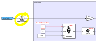

    A 'solution' (not sure if this is the correct one) for adjusting the output frequency is changing the 'Rate Transition' 'Output Port Sample Time' parameter from 10e-5 (smaller code Inverter_000_test) to 5e-5 (bigger code Inverter_001). Block name is 'Rate Transition1'.
    In Inverter_000_test.c and Inverter_001.c 'Rate Transition1' is defiend as

    So in both codes rate transition block constant is 230.0F... still have to investigate how this number is related to 5e-5.

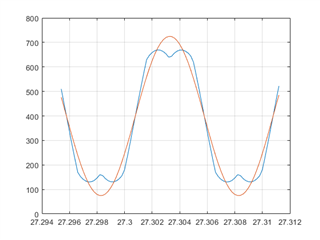

  • Hi Matthew -- I also recorded signals while running in External Mode. DAC and GPIO measure 50 Hz signals and logging signal gives 100 Hz waveform; same as with the 'smaller' code. PWM reference (control) signal is 50 Hz.

    yes, no problem. This is the layout of the smaller application code (file name: Inverter_000_test.slx); 100 Hz DAC output. The same elements are used in the bigger code (file name: Inverter_001.slx); 50 Hz DAC output

  • Hi Mike,
    It is a model overrun condition that is causing this to happen. Basically the model Inverter_001.slx is overrunning the 50usec base task. If you put a GPIO toggle inside this model(top level of the model), the GPIO toggle would occur at the rate of 5KHz. So in the first 100usec the GPIO would go high and next 100usec it would go low. Hence in 200usec it would complete one cycle. Hence 5KHz. This means the model is getting refreshed every 100usec. As can be seen to complete generating 1 RAMP cycle, it takes 10msec assuming 50usec step time. This would generate a 100HZ DAC output. But if the model is overrunning, then to generate 1 RAMP cycle, it will take 20msec as we are now running at a step time of 100usec. Hence the 50Hz DAC output is generated.
