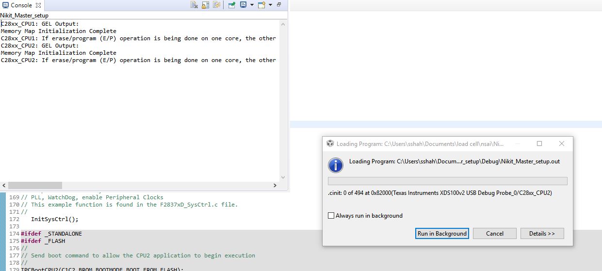

CCS/TMS320F28379D: Takes more than 100 seconds to debug in flash
Part Number: TMS320F28379D
I am using Dual core in flash and using core 1 only. SO it is taking aprrox 2 minutes to compile and debug. Is it somehow I can make this faster as I am not using core 2.
Sagar
  • Hi Sagar,
    Can you please provide some clarification...Do you mean that you are compiling and downloading the outfile by selecting only Core 1 and it is taking more than 100 seconds to download? How large is your application? How large is the .out file? Which emulator are you using?
    Krishna
  • Sagar,
    Adding another question: Do you have many sections in linker command file (like BIOS users)?  If yes, you can use Combine-sections feature in the Flash Plugin GUI to speed up Flash programming.
    Note that XDS100 or 110 are low performance emulators.  XDS200 is the best choice - not as expensive as XDS510/560 but competes with their performance.
    Thanks and regards,
    Vamsi
  • Yes I am compiling core 1 but somehow it does compiling on core 2 as well. My .out file is 480kb. The time i have mention is from clicking debug and for the code ready for me to  resume(F8) on ccs.
  • Below is my .cmd File: How much a difference it would make with XDS 200?

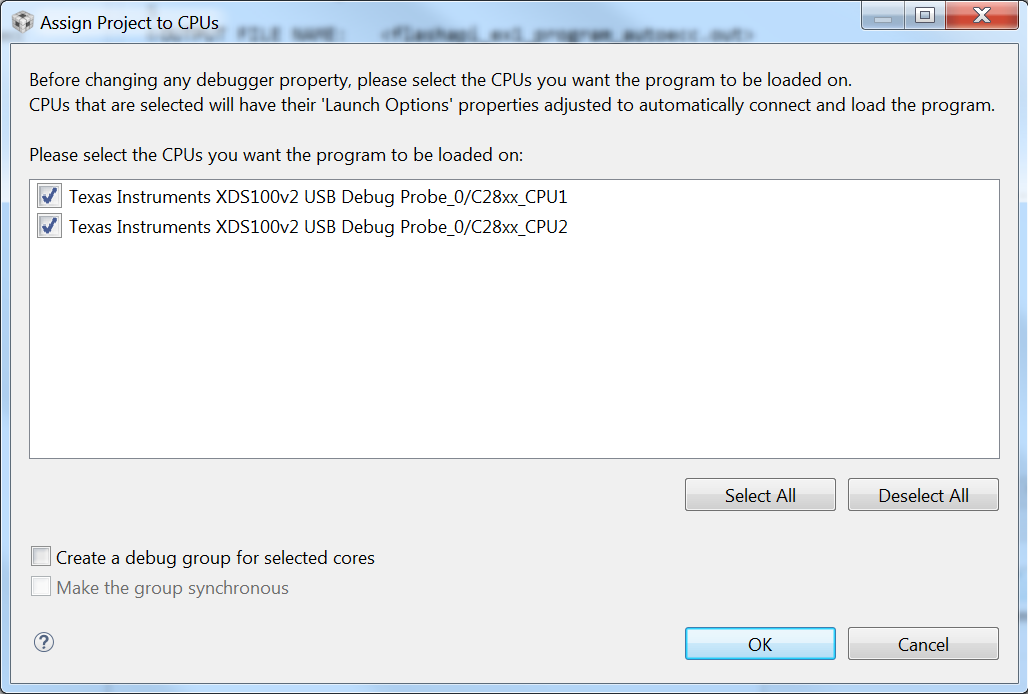

  • Sagar,
    Thank you for the update.
    You don't have many sections; Combine-sections feature does not help you.
    Regarding Plugin: Browse Tools menu in CCS debug view and you will see "On-Chip Flash". This is the Plugin GUI that I am talking about.
    Note that compile time is independent of the emulator that you use. You will see an improvement in Flash program time by using XDS200 emulator. You did not tell which emulator you are using.
    Thanks and regards,
    Vamsi
  • I used XDS100v2.
    So even though I am using core 1 only it will flash core 2 also?
  • Sagar,
    Instead of clicking debug, I would suggest to launch the target configuration file (right click on ccxml and launch) and connect to CPU1 to load the code.
    Thanks and regards,
    Vamsi
  • Still taking same time almost.
  • Sagar,
    You need to configure the project settings to select which cores you want to be loaded.
    Right click on the project -> Properties -> Debug.  You will see below configuration.  Select as you need.
    Thanks and regards,
    Vamsi
  •  I think I selected both core initially but I am not able to find this in properties -> debug.
  • Sagar,
    I will move this post to CCS team. They can answer your last question.
    Thanks and regards,
    Vamsi
  • So Should I post a new Question or they will answer here?
  • Sagar,
    They will reply here.
    Thanks and regards,
    Vamsi
    The easiest thing to do is to delete the debug launch configuration for the project. To do this, go to 'Run -> Debug Configurations' menu in the CCS Edit perspective. Then in the dialog that is opened, look for your debug launch in the left panel. The name of your debug launch should match the name of your project (for a project debug session), or the name of your ccxml file (for a project-less debug session). Then you can right-click on it to bring up the context menu and select Delete.
    Then close the dialog and start a debug session for the project again. You will again see the prompt for which CPU to load the code to.
