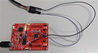

All,
I am trying to perform a firmware update of the MSP430FR2476 LaunchPad board by communicating with the BSL via a serial connection, but I am unable to see the BSL respond to the TX_BSL_VERSION command.  I have read through many of the posts on the E2E forums over this topic, but I have not yet solved this issue.
Below is the code I am using to invoke the BSL via software, which is similar to the suggested invocation method in the MSP430 BSL User's Guide.  This code is a modified version of the LED blink project.

Below is an image of how the serial connection is being made with the LaunchPad board.

    Also, this should be the image of the wiring mentioned in my original post.

  • I may be seeing an issue with the BSL Tx line level.  Below is a capture from the logic port when running the code included in the original question.
    The row labeled "MSP430 Tx" shows that the Tx line is actually low, and is receiving a large amount of cross-talk with the Rx line.  However, this same wiring setup is nice and clean in the OutOfBox demo, and the TX pin is correctly pulled high when not transmitting, as shown below.
    Might it be that the BSL is not correctly setting up the Tx line?  Are there any peripheral setup steps that need to occur before invoking the BSL?
  • All,
    The issue was the voltage level used by the FTDI cable.  I had a 1.8 V FTDI cable, but the MSP430FR2476 requires a 3.3 V UART signal.
