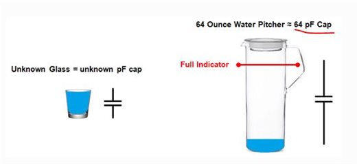

Q3:In "Sample Capacitor Discharge", half of the sample capacitor is 0.5V, so the Vref of the Trip Detector in "Capacitance Measurement" is 1V?
Q4:Also, from the "Charge Transfer Technology", the sample capacitor is Max 64pF, so based on the "Sample Capacitor Discharge", is it correct that the measurement starts from 32pF, which is half the value?
My customer is wondering if it is possible to measure the absolute value of the capacitance detected by the self-capacitance method. When calibration is performed, Gain and Offset are automatically adjusted, so I am wondering if it is possible to turn off the calibration and apply the above idea. I received the following information in another thread before, but I thought the above method would be simpler.
