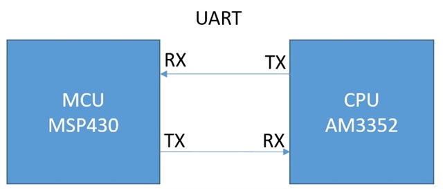

We have an issue about MSP430F5529 UART received.
The architecture as below, Host is CPU, Client is MCU.
Sometime the MSP430 RX lose the UART package. We measure the UART signal, the signal data is correct, the signal quality is OK as well.
The waveform as below, when the MCU lose the package, MCU don't response any data.
We don't know what happen to MCU. Do you have any suggestion?
BTW, we dump the code from NG MCU, the checksum is not correct, maybe the MCU's memory flash has problem.
Henry

    The UART configuration code as below:
     #include <ti/drivers/UART.h>
    UART_Params_init(&uart0_params);
        uart0_params.writeDataMode = UART_DATA_BINARY;
        uart0_params.readDataMode = UART_DATA_BINARY;
        uart0_params.readReturnMode = UART_RETURN_FULL;
        uart0_params.baudRate = 38400;
        uart0_params.readEcho = UART_ECHO_OFF;
        uart0_handle = UART_open(Board_MSP430_UART_A0, &uart0_params);
    There is no CCS/IAR for debugging due to UART port is not enough in our application.
    The issue occurs randomly, maybe few minutes or few days.

  • If this was my system, this plot would tell me that the CPU is doing its job and something is preventing the command from triggering a response. Put a breakpoint in the reponse sending code and see if it is getting triggered. Are you using interrupts or polling?
    Pare your software down to a small program that has the problem and post that so we can look at it. Often, the act of trimming it down uncovers the problem!

    Our code is run on TI-RTOS. I find the task priority will affect UART. So I adjust UART task priority and create two tasks for UART function. One for uart received, the other is uart send.
