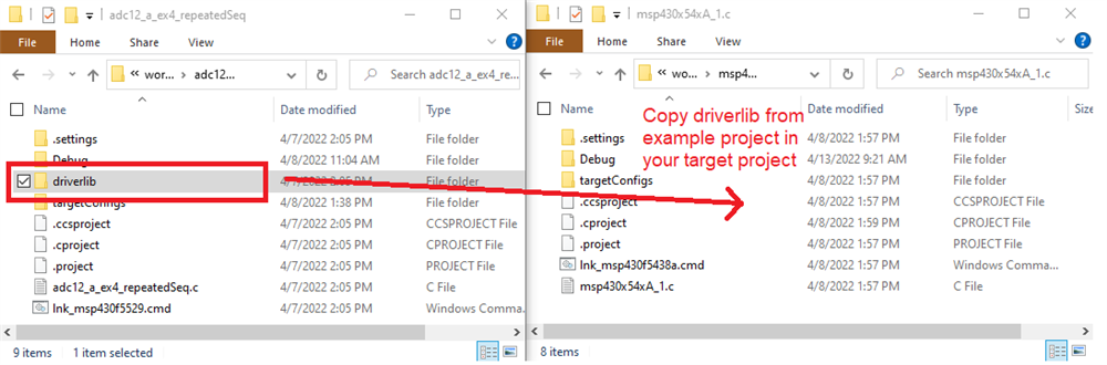

I looked at MSP430F5xx_6xx_DriverLib_Users_Guide-2_91_13_01.pdf pages 23, 24 and 25 etc.
After right clicking on MSP430_F5438A_Driver_error CCS project,
In the Source drop down menu, I have only Format sub menu. I do not have Apply Project Template ... option in my project as shown on below screen capture of my CCS project:
A colleague of mine in another city of my company, has following project, including the driverlib folder:
I do not have driverlib folder as shown in my CCS project:
In my CCS project, how to have Source -> Apply Project Template … menu option?
And how to have driverlib folder in my CCS project please?

  • Hi Swamy Jagannatham ,
    If your colleague has a working version. I would ask to see their build output console and compare it against yours to see what the difference is.
    Evan
  • Hi Evan,
    Thank you very much for the info.
    I will compare and let you know.
    SSJ
  • Hi Evan,
    I did compare my project build output with my colleague's build output and I know where the differences are. However, I am not clear about how to fix the differences.
    I have emailed the two build output txt files to   ticsc@service-now.com email.
    If possible, please see the two files and please let me know of some specific steps I can do to fix the differences and be able to build my project without errors.
    Thanks and best regards,
  • Please attach the two files to your post as I don't have access to that email address.
    Evan

  • Hi Swamy Jagannatham,
    I think the problem is coming from the fact that you don't have the correct driverlib assets copied in your project. Have you installed MSPWare (https://www.ti.com/tool/MSPWARE)?
    Follow these steps:
    1. Import a driverlib example into CCS (Project > Import CCS Projects > Browser to C:\ti\msp430ware_3_80_14_01\driverlib\examples\MSP430F5xx_6xx\adc12_a or your installation direcotry
    2. Copy the "driverlib" directory fron the adc12_a project into your project
    3. Clean and build you project
    I was able to convert a non-driverlib project to a driverlib project following those steps. I will also file a ticket with our team to find out why the steps described in the PDF didn't work.
    Evan
    Apologies, but I'm only able to provide support via the forum at this time. Please help me understand the following:
    1. Do you have MSPWare installed? If not please install from here https://www.ti.com/tool/MSPWARE
    2. Are you able to import and build the adc12_a project using steps described above? If not then we need to figure out what is wrong with your CCS/MSPWare installation.
    3. Please described the steps you are taking to create and build your project
    Evan

    I read through your steps. I didn't see you ever copy the driverlib into your project. If you don't do this CCS wont build the driverlib c assets and the linker will fail. Please make sure you follow step 2 in my post above which I've quoted below. The only reason I had you follow step 1 was so you had an easy place to copy the driverlib folder from.
    Your project should have a folder called "driverlib" in it, see my screenshot below:
    I hope this resolves your issue.

  • It is hard to capture steps 1 and 2 in a screenshot but I did my best below:
    Here is a screenshot of the contents of driverlib:
    Here is a screenshot of my project properties include options:
  • Many, many thanks, Evan.
    I have built the project successfully.
    Thanks again for your help.
