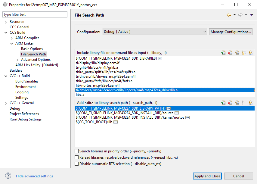

I am using the MSP432E401Y (currently via the MSP-EXP432E401Y LaunchPad).  I am branching my code off of the existing example "i2ctmp007_MSP_EXXP432401Y_nortos_ccs" only with different booster packs. For my application I need to set a specific bit rate for the I2C that is not part of the enumerated types.  I realize that to do this I need to use DriverLib calls, but I can't seem to get the DriverLib added to my existing project.  I have downloaded other example projects that use DriverLib, and those worked fine.
  • Hello Mitch,
    could you post a console output after a project build command?
  • I have a different console output based on the method I use to merge the two projects. I just need to know how to add the DriverLib to an existing project for the MSP432E401Y. (Specifically to the "i2ctmp007_MSP_EXXP432401Y_nortos_ccs" example project so that I can set a specific I2C clock speed).
  • Mitch,
    check this upper in blue:
    Does it help?

  • Interesting, I actually do see "ti/devices/msp432e4/driverlib/lib/ccs/m4f/msp432e4_driverlib.a" in my file search path. The example code that I am trying to pull from is "i2c_mastermode_simple_transfer_MSP_EXP432E401y_nortos_ccs". I guess I thought that the DriverLib was not included because I cannot include the line "#include <ti/devices/msp432e4/driverlib/driverlib.h>" as done in the i2c example.

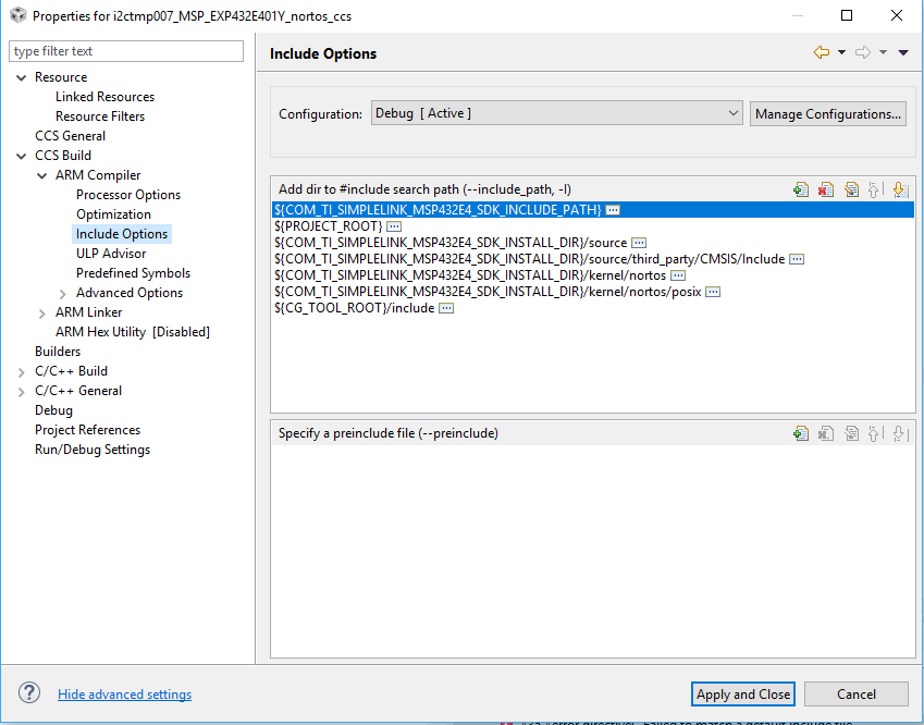

  • Could you check:
    and the "Linked Resources" almost top on the left of the above screen?
    The
    #include <xxyz/xyz/driverlib.h> and etc.
    statements need to be realigned with the paths above and the "Linked Resources".
  • It has ti on the list, and the driverlib is at: #include <ti/devices/msp432e4/driverlib/driverlib.h>. I see you have the same example open that I did, are you able to use "#include <ti/devices/msp432e4/driverlib/driverlib.h>" in i2ctmp007.c?

  • "C:/ti/simplelink_msp432e4_sdk_2_20_00_20/source/ti/devices/msp432e4/inc/msp.h", line 53: fatal error #35: #error directive: "Failed to match a default include file"
    Line 53.
    Someone at TI should find why __MSP432E401Y__ is not defined.
    Could you add the __MSP432E401Y__ symbol to your project properties and check?
    TI-RTOS version (i2ctmp007_MSP_EXP432E401Y_tirtos_ccs) compiles fine.
  • Yes, that fixed the problem, thank you Tomasz!
