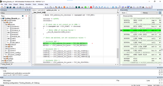

    While downloading code into MSP430 through IAR, I noticed that in faulty board (not detecting in EMDC after calibration) I am unable to access Memory, Flash , RAM through Disassemble window.
    Today, I was trying to reprogram it and found that when I click "Pause button" ( Red highlighed in below image) , I was able to see all memories in disassembly window.
    Here I noticed that the code is starting from
    "/* Calibrate REF */
     REFCAL1 = *(TLV_address_for_parse + TLV_CAL_REFCAL1);"
    Earlier , It was starting from main().
    Now I clicked on Next statement button ( mentioned in RED mark)
    I got under mentioned Pop- up.
    Can you help me in solving this issue?

  • Can you help me in solving this issue?
    In a MSP430I2031 the reference calibration data is stored in information memory. Given that your boards are halting in LPM4 in the __low_level_init() function due to an invalid checksum in the reference calibration (TLV) think the issue is somehow that the information memory with the reference calibration got erased.
    I don't have the hardware to investigate, but not sure if anyone from TI explain how to resolve the issue without replacing the MSP430I2031.
  • Hi Devesh,
    Like Chester said, if the TLV value in the flash information memory is erased by some mistake that will cause something wrong in the start up code(SUC). The SUC is the _low_level_init() function. The calibration operation will store some calibration value (TLV) which is in the information memory. I just suspect that if there is something wrong when update the calibration value that cause the information memory abnormal. f
    Some details you can see in the chapter14 in technical reference manual.
    I suggest that you check the information memory.

    The calibration value is still stored in information memory. And the TLV is stored in info memory too. The TLV value is test by ATE test for each device. Calibration will read the information memory and add the calibration value and re-write all the data to info memory(TLV+ calibration value). If the info memory is already erased by user. The calibration operation will read the changed TLV and re-write it to info memory. That is why you calibration with the same error. Because the true TLV is already lost. If you want to recovery the TLV value it will take a lot of efforts. ATE testing is required to test out and rewrite the device specific TLV data for each chip.

    The TLV data store in information memory(0x1000-0x13ff) form 0x13C0. If you select eras information memory, it will eras the TLV data. It will cause this issue.
    The TLV date is tested of each device before release to market, it is unique. TI has method to recover it , but the cost and efforts is very large. It may exceed a new one.
