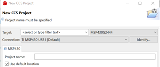

I'm try to configure a CCS project (New >> CCS project) with the MSP430G2444 but I don't see the correct device
It is supported this device ?

Hi Stefano,
Did you look through the drop down?
I see it. Sometimes its easier to just scroll down and look instead of typing in the search bar on the left.

Hi Stefano,
So you are using CCS v11.2? hmm that is odd.
Can you check if you are using the most up to date MSP430Ware SDK?
https://www.ti.com/tool/MSPWARE
I would double check your CCS set up process as well.
You can refer to this: https://software-dl.ti.com/ccs/esd/documents/users_guide_11.2.0/index_installation.html
Take a look at section 3 and 4 specifically in case anything was missed.
Let me know what you find.

Hi Henok, in the mean time I was uninstall V11 and install V6 because my old project is based with Grace Tool and Grace is not supported in V11. Now I have V6 and after the upgrading of the IDE is present the required component.

It looks to be an issue with the New CCS Project Wizard in CCS 11.2 - reported in Some MSP430 part numbers missing in CCS 11.2 New CCS Project Wizard
