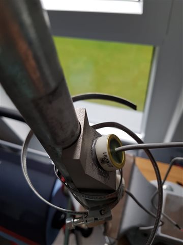

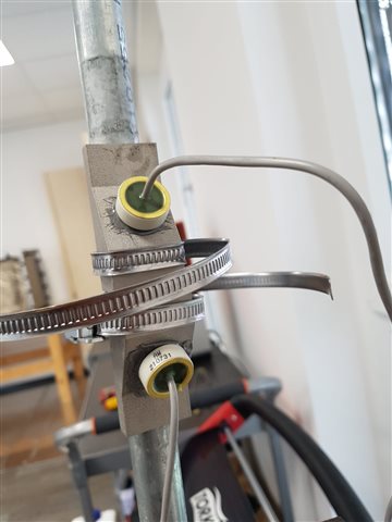

We have already modified hardware of the EVM to do flow measurement, 1MHz piezo transducer is glued with 3D printed coupler which is attached one the pipe. We have installed piezo next to each other and sound wave travel in a V-shape into the metal pipe. Pipe is full of water without any air bubble.

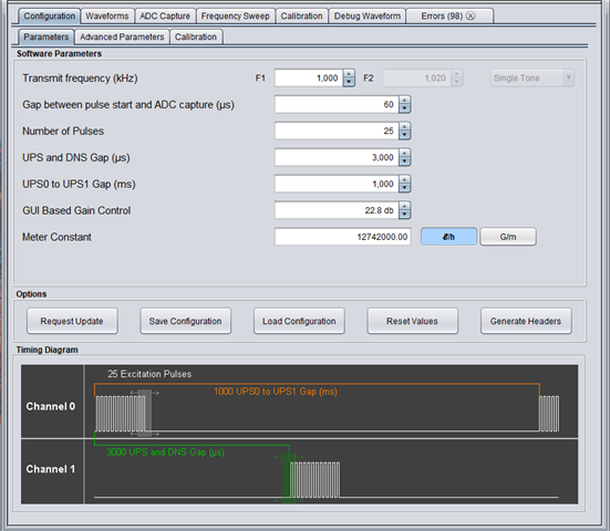

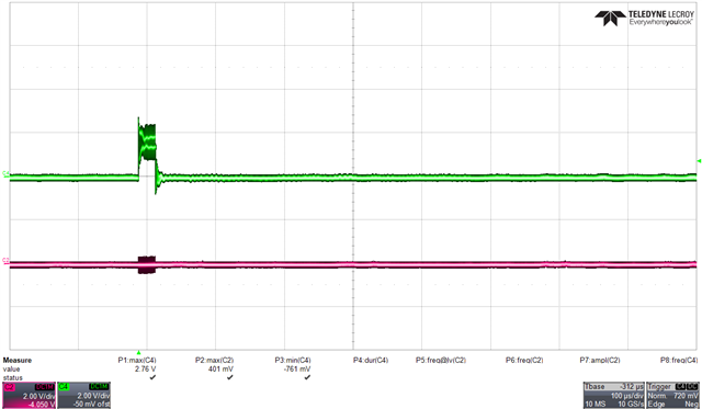

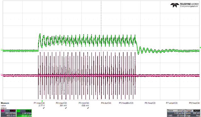

    Below you can see the ADC capture, parameters, Oscilloscope waveform and our 3D fixture:

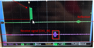

    Can you use your scope to capture more of the RX signal? Currently your capture only shows the TX signal (green). The RX signal shown (pink) is purely cross-talk. The true RX signal will appear later in time after it as traveled through the media. An example of an RX signal (boxed in red):
    Once you are able to see the RX signal I would recommend making small adjustments to the physical location of one of the transducers to see if you can improve the RX signal strength.

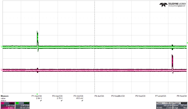

    I have adjusted my scope and I did not see any RX signal as in your image RX signal in pink color , you can see in below images:
    To be sure transducer and EVM works fine, I took a bowl full of water and put both piezo in front of each other in the bowl. Getting really great RX signal as per expectation. Here is the image:
    It seems like metal pipe has alot of attenuation therefore RX signal can not appear.

  • Thanks for sharing the scope captures.
    Yes, it seems like there is too much attenuation though the 3D fixture and pipe.
    Have you tried making small adjustments to the physical positioning of the transducers? There may be refraction at the interface boundaries that may shift the ideal placement of the transducers away from the theoretical best position.
    You might also try mounting the transducers on opposite sides of the pip to see if you can get a clearer signal.

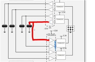

    The abs max voltage on USS CHxIN is 1.65V. However the protection circuit on the output of the RX amplifier will only clamp the voltage between 0 and ~3.5V based on the diode selection. As an example, if a transducer is driven, the RX is also driven directly (see diagram below). This will likely result in a large signal at the output of the RX amplifier. The switch protects the device from seeing this.
