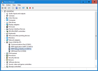

    My Windows 10 Pro Device Manager looks like this:
    The indicated devices disappear and reappear as the EVM is disconnected and connected.  COM17 is an external TTL UART to USB device.
    So, no COM ports.

    No change to the Windows 10 Pro Device Manager.  Only "MCU COMM HID to Serial Bridge" and "MSP Tools Driver" come and go.  No COM ports.
    Am I lacking suitable drivers on the Windows end, or is the EZ-FET (and the HID bridge) not being programmed to register UARTs?
  • Open the actual Device Manager (devmgmt.msc) instead of the Windows 10 settings panel. I have my EVM430-FR6047 plugged in and the two COM ports do not appear in the Windows 10 settings panel but do in Device Manager.
    You should see "MSP Application UART1" and "MSP Debug Interface". You'd be using the Application UART port for communication with your software. Remove the RXD and TXD jumpers on J5 and connect/populate the RXD and TXD jumpers on J2.
    EDIT: I'm using a rev 2.0 board, and the jumpers are not numbered the same. Based on your picture, disconnect the RX/TX jumpers on J1, make sure they're connected on J3.
