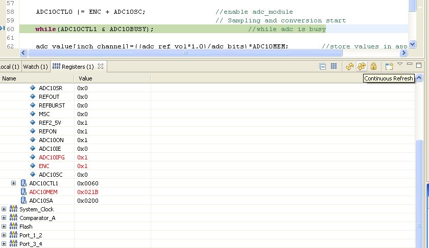

I started using ADC module of MSP430 & do its settings as recommended. But when set its ADC10SC bit in the program by "ADC10CTL |= ENC + ADC10SC", it do not get high in register column during debugging.. But still my ADC10MEM shows right result. My question is when my sampling bit do not start, how the conversion occur.
I am new to this controller, I might be missing something. Kindly help.

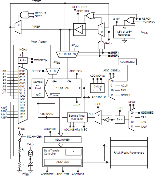

Hello Deepak Bansal.
theoretically this register can be read by the compiler registers.
Below is the block diagram of the A / D and also leave a link to theuser's guide of the family msp430x2xx.
I would like to know what compiler are you using our reed?

Hi Rodrigo, I have used MSP430G2553. You can see that after instruction "ADC10CTL |= ENC+ ADC10SC"The register values changes & ADC10Sc do not get set
See below:

may be in ur instruction '+' sign is interpreted as binury plus so check it. and see that in ur registers adc10ifg is set.means interrupt is generated. so hardware may clear adc10sc bit.
Hi Hardik,
As you can see in above snapshot adc10ifg bit gets set. & sign you were talking about works good in all other cases.

Know your tools! :) In this case the (de)bugger and how it works.Deepak Bansal said:But when set its ADC10SC bit in the program by "ADC10CTL |= ENC + ADC10SC", it do not get high in register column during debugging.
When you set ADC10SC, the ADC conversion starts. Unless you have heavily changed the ADC configuration, the ADC is running on its own oscillator, and while the debugger is busy stoping the CPU, fetchign variables etc, which is a very slow process (compared with processor operation), the conversion was already completed long before the debugger checks the register content.
Don't forget that the ADC is a separate piece of hardware. If you need synchronisation between the ADC and teh debugger, you'll need to clock the ADC by e.g. SMCLK and tell the debugger to stop the clocks. Else the ADC will just don't care for your breakpoints and debugger activity and will be done long, long before you will be able to see anything on your PC.
Always keep in mind that the debugger cannot freeze time, and things that are happenign in real-time will cmplete in real-time, whether you have stopped the CPU by teh debugger or not.
