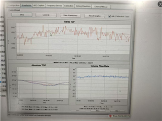

      we use DN20 tubes, finished calibration,
      then measure 100L/H, and 9L/H
     The VFR of the USS data are below:
           100L/H                                                                                             9L/H
, right? It feels quite different from the theoretical value, I don't know where I haven't operated it?  please  point out us
    Your data does not look good from my side.
    At 9L/H, the mean dTOF is around 997ps and the STD of dTOF is around 596ps. The STD value is too high than normal. It could indicates there are big noise in your receive signal. It could related to improper parameter settings and/or transducer and pipe connections.
    You need to lower the STD value first before you start calibration process. You can refer to this link how to tune your parameters first to get a better ADC capture signal first.
    https://dev.ti.com/tirex/explore/node?node=A__AUxLkAvzLrljvLBB0bSqSw__MSP430-ACADEMY__8HaEUeq__LATEST
