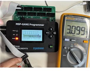

First, we can check our target PCBA is ok, when we use the J-link tool to be programmed it can be successful.
But when we try to program MSP(MSPM0L1305) devices with MSP Gang Programmer.
I am unable to program/erase/read target devices. Getting an error of MCU device initialization failed.
Please help me to resolve this.
Attaching the snapshot of desktop application's version info and error window.

    I don't see anything upon first review that stands out.  Are you sure you are using channel 1 of the MSP-GANG?  How long is your programming cable?
    I see that you mention that it works with a J-link, but a common issue I see is people getting the programming headers flipped/mirrored.   Can you monitor the VCC line and see if you're getting power from the MSP-Gang where you expect?
    It seems like the issue is between the MSP-GANG and the MCU, not between the PC and the MSP-gang.

    Thanks for your reply. Only 1 channel used. The cable length about 50cm which connect the programming fixture .  At the same time ,i have check the VCC is 3.3V when software "VCC on/off "buttom is activates.

    I see you are getting a "device initialization failed" error.  Do you get the same error if the programming cable isn't connected at all?   My next step would be to very closely review the wiring, especially if manually wiring it into the connector as in the picture.

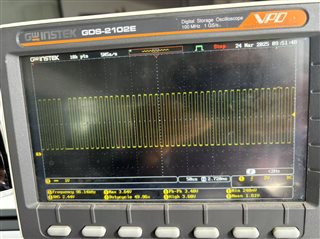

    I see above that you confirmed voltage was on the cable, have you confirmed that power is reaching the target board?  Is it possible to scope the SWD lines on the actual target board so we can see if the SWD commands are reaching a powered device?

  • I have measured the signal form SWD whcih on PCBA, the signal looks like ok.
