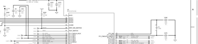

We are currently using the MSP430F5438A XT1 external crystal oscillator 10Mhz.
I looked at the slau208q.pdf manual. When writing about XT1DRIVE, it only talks about the driver configuration in XT1 LF mode.
Question 1: In XT1 HF mode, is the configuration of this drive capability still valid?
Question 2: In XT1 HF mode, 10M crystal oscillator. Can XT1DRIVE be set to 10,11?
Question 3: When using an oscilloscope to detect the trigger signal sent by MSP430F5438A to the 10M crystal, no trigger level was found. When working normally, a 3.3v high pulse trigger signal can be seen output. Do you know why this could be happening?
Question 4: Is it better to use XT2 in high frequency mode? The configuration of XT2DRIVE is definitely for high frequency.
Zack
Hi, Zack
Please let customer check their crystal or PCB vendor changes.
Need your confirmation, so I can close this E2E thread.
