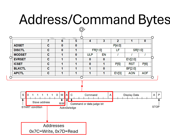

I'm new with embedded systems and am trying to get a LCD board lit up with an MSP chip as master and LCD as a slave.
I've used the Command register (on page 6 in the doc) to turn on and off all LCD segments but cannot light up specific ones.
Page 9 of the doc shows an example of setting this up and I have data on my protocol analyzer with the transaction going through.
My transaction data is ICSET -> ADSET -> what bits in the first 2 segments I want to display. Which matches the example, but doesn't work.
What am I missing?
Thanks.
LCD board documentation
Code

  • 0x79 is APCTL(C=0,AON:AOF=01) which the table (p.7) says means all-off[ignore DDRAM]. It seems as though you want 0x78 (AON:AOF=00) which means "use the DDRAM".
    Also do you need to send a MODSET(C=0,EN=1) i.e. 0x48? It says EN=0 after reset, but you mentioned being able to light up the segments without it. (Or maybe AON:AOF=10 ignores EN?)
  • I think that was it, I missed the phrasing on APCTL.
    Setting it to 0x78 fixed it.
    I don't think I need a  modset for it to work but it was suggested I try it out.
