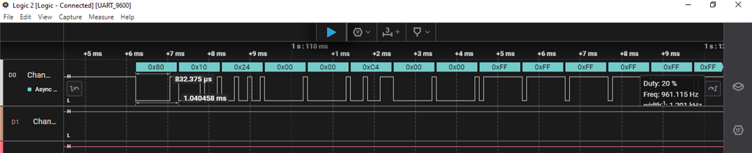

Observed Behavior:
  • Sync byte is transmitted successfully.
  • Target does not send ACK (0x90).
  • Logic analyzer shows correct TEST/RST waveform.
  • UART RX from target remains idle or produces invalid data.

    Observed Behavior
    • Subsequent commands often return error codes (0x54 header incorrect or 0x51 length incorrect).
    • Logging confirms the host is transmitting 0x80 as the first byte, but the MSP430 sometimes misinterprets it.

    As you suggested, I also measured the UART output on a logic analyzer to confirm.

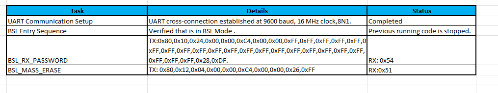

    As per the  FRAM BSL User Guide (SLAU550) .I am transmitting the BSL Core Command but it is responding back as given below.
    BSL_CORE_Command TX: 0x80,0x3B,0x04,0x00. RX: 0x54,0x51,0x51,0x51
  • What you sent is not a valid command per the User Guide; see section 4.1.1. You must have the Header, two bytes which specify size, the actual command with associated data, then the two byte checksum.
    For example, BSL_RX_PASSWORD is sent as described in section 4.1.5.2. All BSL commands have examples such as these. Please read the user guide.

    Thanks for your guidance — I’ve now corrected my packet format according to SLAU550.
    Current Status
    • I am receiving valid responses for all commands (RX Password, Mass Erase, RX Data Block, CRC Check, Load PC).
    • Packets are acknowledged with the expected 0x00 ACK header.
    • CRC check returns the correct checksum.
    So the UART BSL communication seems fully functional now.

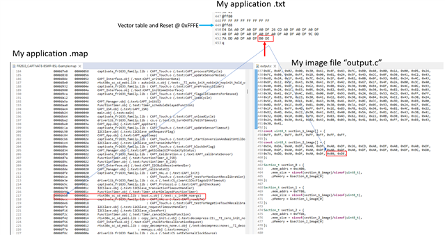

    After loading my firmware image (.txt format, starting at @C400) and issuing Load PC to 0xC400, the device does not appear to run the application.
    My Questions
    1. Firmware Format – I am using a TI-TXT image generated by CCS. Is this directly compatible with FR2433 UART BSL, or do I need to convert it into a raw binary/intel-hex format before programming?
    2. Start Address – Is 0xC400 the correct entry point (PC) for MSP430FR2433 applications built with CCS? Or should I be using a different vector (e.g., reset vector at 0xFFFE)?
    3. Load PC Command – After a successful program + CRC check, I send BSL_LOAD_PC (0x17) with 0x00 0xC4. The command is acknowledged, but no application runs. Could this mean my image is linked at the wrong base address, or the reset vector is not set?
    So at this point, the communication layer is solved, but I need guidance on verifying firmware image format and correct execution start address for FR2433 over UART BSL.

  • As requested, I’m sharing a content of  TI-TXT file generated from CCS and Array converted for application for UART_BSL. This includes the start address (0xC400 region).
    I would like add one more point that the I Verified the TI-TXT file generated by CCS is uploaded to the MCU using Uniflash Tool, while the result is Positive.
    Could you please confirm:
    1. Is the start address 0xC400 correct for FR2433 application code when using UART BSL?
    2. Does the TI-TXT format above look valid for BSL programming?
    3. Should I explicitly trigger a jump to the reset vector after load, or will BSL handle that?
  • Hi Keshavamurthy,
    Yes, the TI-TXT format is correct and the arrays also look fine.
    Yes, 0xC400 is the correct, and yes this is where the application image is placed in FRAM.  However, this is not typically where the actual application start (boot code portion of your application) is located. The location is stored as a vector in the RESET location 0xFFFE as shown below in my example, both in the .txt output file and my memory structures.    Check your application's .map file to see where this comes from.
    I attached a ppt with the snippet below in case it is difficult to see.FR2633 example BSL mapping.pptx
    So for your application, use 0xC4C0 as the boot address.
