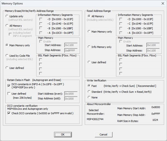

  • Recalibration is possible using "msp430g2x44_dco_flashcal.c."
  • The "FET-Pro430" "Memory Option" does not have any effect.

    • The error log when the writing failed is below.
      "DCO constants verlifiacation... failed
