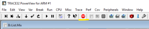

It is observed that Lauterbach used for TI(MSPM0G351X) target shows "Erasing SD 0x00..0x7FFFF" continuously. This is causes flashing incomplete.
Solution :
Step 1 : Click 'STOP' option as shown below
Step 2 : Go to CPU → System Setting → CpuBreak : Change it to Enable from Denied (Default is Denied - This is required for UDS $11 01 service to make sure control not halts at start after reset) and break the execution.
Step 3 : Execute below command Flash.Erase ALL (After Step 1 or Step 2, do not perform any in-target or CPU reset.)
The above steps will enable to re-flash the .elf
