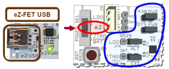

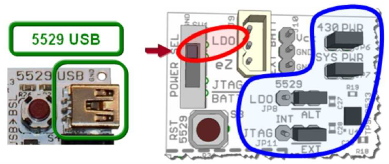

I'm testing the demo code that is pre-loaded on the MSP430F5529 USB Experimenter’s Board. When I pressed the S3 or S4 (reset) buttons, they don't seem to have any effect on the state of the processor. Do I need to change any jumpers?

    S3 should reset the device (and the LCD/backlight) if you power the board using the 5529 USB connector at the top-right of the board and the POWER SEL switch and jumpers are set as shown here:
    S3 should also reset the device (and the LCD/backlight) if you power the board using the eZUSB connector at the bottom-left of the board and the POWER SEL switch and jumpers are set as shown here:
    If you use the eZUSB configuration, you will also need to remove the TEST jumper from JP16.

  • Thanks, Peggy. When I removed the Test jumper from JP16, the RST button started working. Could you please tell me more about the role of this jumper? I couldn't find much info about it in the board's user guide.

  • Binh,
    According to the schematics in section 5 of the User's Guide (http://www.ti.com/lit/ug/slau330a/slau330a.pdf), the TEST jumper connects the SBWTCK signal from the eZ430 emulator to the MSP4305529 device.  This signals is one of the two signals used by the spy-by-wire communication between the emulator and the device.  When the TEST jumper is connected, the spy-by-wire communication disables the functionality of the reset button on the board.  Removing the TEST jumper disables the communication thereby enabling the functionality of the reset button on the board.  Similarly, removing the DVCC jumper disables the voltage-level translator between the emulator and the device.  This disables spy-by-wire communication and enables the functionality of the reset button.
