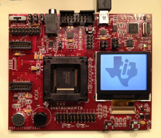

I was trying to debug MSP430F5438 Experimenter board using CCSv5, but it says No USB FET was found. I found someone said USB Interface MSP-FET430UIF is needed for debugging. I used to debug MSP430 launchpad successfully without using a debug interface, so do I need MSP-FET430UIF to debug MSP430F5438 Experimenter board? If so, why MSP430 launchpad does not require that?

    Yes, you need the MSP-FET430UIF to debug the MSP-EXP430F5438.  This is not required for the MSP-EXP430G2 since the emulatoin circuitry is provided on the LaunchPad itself.
    LaunchPad is an experimenters board, not just a processor. Many experimenter boards (not all) include a stripped-down version of the FET430UIF that provides programming and debugging capabilities for just the target processors of the board.
    The FET430UIF, however, supports all MSPs, both, 4-wire and SBW JTAG protocol, auto-adjusts to the supply voltage on self-powered targets or provides adjustable supply.itself.

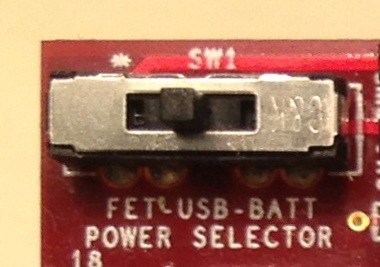

    In that video you can see that SW1 is all the way to the right, which means the board is battery powered.  Move it to the middle position to power it from the USB connection.  The USB interface is used to give you access to the UART on the MSP430F5438A.  You can find more details in the schematic located near the end of the user's guide.
  • I plugged in the USB interface and sw1 was positioned in the middle ,but the screen of my experimenter board does not wake up,it is just blinking ,why?

  • When I power it, the LCD is blinking without any thing shown on it.
  • Are your observations the same when you power the board from batteries?  If not, explain how the results are different.
  • When I plug in the USB, the LCD is blinking dimly regardless of the way I power it. When I disconnect the USB, the LCD is off even when I use battery to power it.
  • In what position do you have the power selector switch (SW1)?
    I was able to recreate the problem you decribed.  If SW1 is set to FET, and the board is powered by USB, then yes the screen will flicker.  This is an incorrect setup.  If SW1 is et to FET and the board is powered by batteries, then nothing happens.  This is an incorrect setup.
    Any of these configurations is correct:
    SW1 set to FET, and MSP-EXP430F5438 powered from the MSP-FET430UIF.
    SW1 set to USB, and MSP-EXP430F5438 powered from the USB cable connection (best if your computer is AC powreed so it does not limit the USB current).
    SW1 set to BATT, and MSP-EXP430F5438 powered from two AA batteries (in good state of charge of course).
    I verified all of those three.  You may need to adjust the display contrast for each power source since the voltages supplied may vary slightly between them.
