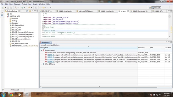

    Is it required to use assembly here as I need to jump to BSL location??. I tried to build the basic code for initial testing to understand but i get linker errors. I am using the 5438A experimenter board to test the existing code.
    I am hereby attaching my project and snapshots.. I am using CC5.2

    1. Take the CCS F5438A project found in SLAA450/Custom_BSL_Zip_File/5xx_6xx_Example_BSL_Source and import it into CCS.
    2. Remove the BSL430_PI_TA.c. Replace it with the BSL430_PI_USCIA.c file from SLAA450/Customer_BSL_Zip_File/5xx_6xx_BSL_Source/Peripheral_Interfaces/USCIA_UART/BSL430_PI_USCIA.c
    3. in BSL_Device_File.h add this line: #define USCI_PORT_SEL P3SEL. Note that this is for using UCA0RXD and UCA0TXD pins P3.4 and P3.5 - you need to also change the line in the PI_USCIA file to set BIT4 + BIT5 instead of BIT5 + BIT6. If you want to use a different USCI module you'll need to change this and change the BSL430_PI_USCIA.c file accordingly.
    4. You'll have to make some modifications to the BSL430_PI_USCIA.c file to get it to build in CCS. Remove the __no_init from in front of some variables, and get rid of the statements like #pragma required=BSL430_PI_Version that throw errors.
    5. At this point when you build you'll probably get the errors like you do in the image you posted above - you need to set the Optimization for the compiler so that the code will fit in the BSL area of memory. Go to Project > Properties. In this dialogue you are going to set several settings.
    • under General, set Output format to "legacy COFF"
    • under Build > MSP430 Compiler > Optimization set Optimization level to 4 and Control speed vs. size trade-offs to 0 (this will optimize fully for code size so it will fit in the BSL area)
    • under Debug > MSP430 Properties scroll down to "Download Options" and select "Erase main, information, and protected information memory" and check the box "Allow Read/Write/Erase access to BSL memory"
    • under Build select the Steps tab and select "Apply Predefined Step" and pick "Create Flash image TI-TXT" (this will make a binary TI-TXT file in your Debug folder. This is the binary BSL image you'd load in a production environment).
    Now when you click OK, you should be able to build and then load the BSL into your F5438A (note that in debug it will appear like there's no source - this is because it's running out of the BSL area and there is no main - this is normal behavior).

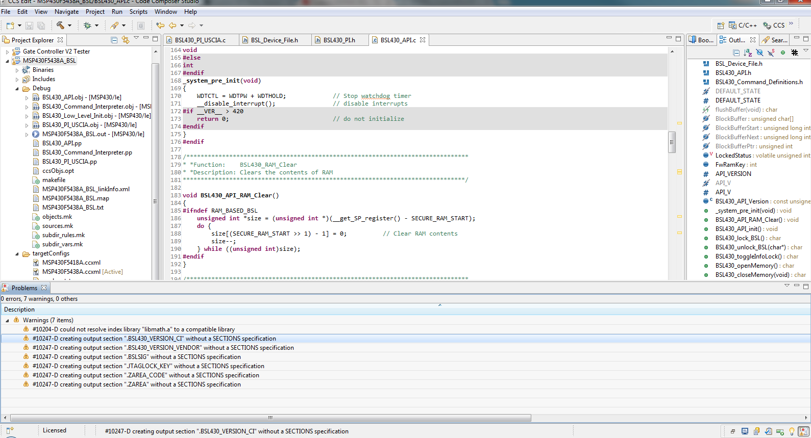

    I'm also using MSP-EXP430F5438A and I've made the steps that Katie said and I managed to compile BSL example, and customize it to work with UCA1 on port 5 pins 6 and 7.  At compilation I receive some warnings and I don't know what exactly they means:
    #10247-D creating output section ".JTAGLOCK_KEY" without a SECTIONS specification MSP430F5438A_BSL
    #10247-D creating output section ".BSLSIG" without a SECTIONS specification MSP430F5438A_BSL
    #10247-D creating output section ".BSL430_VERSION_VENDOR" without a SECTIONS specification MSP430F5438A_BSL
    #10247-D creating output section ".BSL430_VERSION_CI" without a SECTIONS specification MSP430F5438A_BSL
    #10204-D could not resolve index library "libmath.a" to a compatible library MSP430F5438A_BSL
    #10247-D creating output section ".ZAREA_CODE" without a SECTIONS specification MSP430F5438A_BSL
    #10247-D creating output section ".ZAREA" without a SECTIONS specification MSP430F5438A_BSL
    #10247-D creating output section ".BSL430_VERSION_API" without a SECTIONS specification MSP430F5438A_BSL
    And when I run the code the CCS Debugger is starting and is loading the program in memory and after that is throwing an error "Load program error" with the following mesaage: "MSP430F5438A_BSL.out: a data verification error occurred, file load failed".
    My problem is that I think I erased the old default BSL with the new one which is not working, because when I point my program to 0x1000 to enter in BSL the only thing it does is to restart the program again.
    And I think the problems that I have are from project setup and compiling link etc. I use CCS 5.5 and the compiler version is 4.2.3
    Does anybody knows how can I get rid of those warnings? and hopefully after that my custom BSL will work.
    Thank you,
    Claudiu
  • Hi Claudiu,
    I just tried this with the latest SLAA450 download and CCSv5.5 and I did not have any issues and did not get the warnings that you did. The only way I was able to reproduce your issue was if I used the default MSP430F5438A linker file instead of the customized linker file for the BSL. Make sure that you are using the linker file that comes in the SLAA450 download in the folder at SLAA450/5xx_6xx_Example_BSL_Source/CCS_v5.5.0_BSL-5438A/lnk_msp430f5418a.cmd.
    This may have the same name as the linker file you already have, but if you check the contents you should see the linker file defines all of these things like .ZAREA_CODE and .JTAGLOCK_KEY etc. I think this is your issue. I've also attached this customized linker file here: http://e2e.ti.com/cfs-file.ashx/__key/communityserver-discussions-components-files/166/2110.lnk_5F00_msp430f5418a.cmd
    Katie

  • Hi Katie,
    Thanks to your great help, I have downloaded demo program into my 5438A board by using both BSL entry timing sequence and the sentence:((void (*)())0x1000)();
    Now I want to change the original BSL program to use a different USCI module :p3.4 and p3.5. So I modified the project (CCS_v5.5.0_BSL-5438A) according to this thread step by step, but when I build the project, there are some errors, in case of potential error that is made by my modification, I build the original project again, but there still have some errors as following :
    "../lnk_msp430f5418a.cmd", line 152: error #10099-D: program will not fit into available memory. placement with alignment fails for section ".BSL430_VERSION_CI" size 0x1 . Available memory ranges:
    BSL430_VERSION_CI size: 0x1 unused: 0x1 max hole: 0x1
    "../lnk_msp430f5418a.cmd", line 154: error #10099-D: program will not fit into available memory. placement with alignment fails for section ".BSL430_VERSION_PI" size 0x1 . Available memory ranges:
    BSL430_VERSION_PI size: 0x1 unused: 0x1 max hole: 0x1
    error #10010: errors encountered during linking; "MSP430F5438A_BSL.out" not built
    >> Compilation failure
    gmake: *** [MSP430F5438A_BSL.out] Error 1
    gmake: Target `all' not remade because of errors.
    **** Build Finished ****
    The errors shown above are identical to my modified project. I have noticed that the cmd file in the project is named as lnk_msp430f5418a.cmd, so I wonder if this file leads to all the errors.
    Hopefully, you can give me some advice.
    Wang
  • Hi Wang,
    To me those error messages look like the linker is having problems placing the BSL version information. However, this version information is not strictly necessary(though it can be useful), so you could try commenting out the lines that set these to see if it helps. The BSL is unfortunately pretty tight in the 2kB of BSL Flash, so you can run into problems when making modifications if the program doesn't compile small enough.
    -Katie
  • Hi Katie,
    Thank you for you really fast reply. I have commented out these lines to see if this time I can build successfully, but this time, another error happened (actually it also happened last time, but I didn't noticed it):
    **** Build of configuration Debug for project MSP430F5438A_BSL ****
    "D:\\wzl\\software\\TI\\CCSV5\\ccsv5\\utils\\bin\\gmake" -k all
    'Building target: MSP430F5438A_BSL.out'
    'Invoking: MSP430 Linker'
    "D:/wzl/software/TI/CCSV5/ccsv5/tools/compiler/msp430_4.1.2/bin/cl430" -vmspx --abi=coffabi -O4 --opt_for_speed=0 -g --advice:power="all" --define=__MSP430F5418A__ --diag_warning=225 --display_error_number --diag_wrap=off --silicon_errata=CPU21 --silicon_errata=CPU22 --silicon_errata=CPU23 --silicon_errata=CPU40 --single_inline --remove_hooks_when_inlining --printf_support=minimal -z --stack_size=160 -m"MSP430F5438A_BSL.map" --heap_size=160 --use_hw_mpy=F5 -i"D:/wzl/software/TI/CCSV5/ccsv5/ccs_base/msp430/include" -i"D:/wzl/software/TI/CCSV5/ccsv5/tools/compiler/msp430_4.1.2/lib" -i"D:/wzl/software/TI/CCSV5/ccsv5/tools/compiler/msp430_4.1.2/include" -i"D:/wzl/software/TI/CCSV5/ccsv5/ccs_base/msp430/lib" --reread_libs --warn_sections --display_error_number --diag_wrap=off --xml_link_info="MSP430F5438A_BSL_linkInfo.xml" --rom_model -o "MSP430F5438A_BSL.out" "./BSL430_PI_TA.obj" "./BSL430_Low_Level_Init.obj" "./BSL430_Command_Interpreter.obj" "./BSL430_API.obj" -l"libmath.a" -l"libc.a" "../lnk_msp430f5418a.cmd"
    <Linking>
    remark #10371-D: (ULP 1.1) Detected no uses of low power mode state changes using LPMx or _bis_SR_register() or __low_power_mode_x() in this project.
    error #10008-D: cannot find file "libmath.a"
    remark #10372-D: (ULP 4.1) Detected uninitialized Port A in this project. Recommend initializing all unused ports to eliminate wasted current consumption on unused pins.
    remark #10372-D: (ULP 4.1) Detected uninitialized Port B in this project. Recommend initializing all unused ports to eliminate wasted current consumption on unused pins.
    remark #10372-D: (ULP 4.1) Detected uninitialized Port C in this project. Recommend initializing all unused ports to eliminate wasted current consumption on unused pins.
    remark #10372-D: (ULP 4.1) Detected uninitialized Port D in this project. Recommend initializing all unused ports to eliminate wasted current consumption on unused pins.
    remark #10372-D: (ULP 4.1) Detected uninitialized Port E in this project. Recommend initializing all unused ports to eliminate wasted current consumption on unused pins.
    remark #10372-D: (ULP 4.1) Detected uninitialized Port F in this project. Recommend initializing all unused ports to eliminate wasted current consumption on unused pins.
    "../lnk_msp430f5418a.cmd", line 222: warning #10374-D: Interrupt vector "RTC" does not have an interrupt handler routine.
    >> Compilation failure
    "../lnk_msp430f5418a.cmd", line 223: warning #10374-D: Interrupt vector "PORT2" does not have an interrupt handler routine.
    "../lnk_msp430f5418a.cmd", line 226: warning #10374-D: Interrupt vector "USCI_B1" does not have an interrupt handler routine.
    "../lnk_msp430f5418a.cmd", line 227: warning #10374-D: Interrupt vector "USCI_A1" does not have an interrupt handler routine.
    "../lnk_msp430f5418a.cmd", line 228: warning #10374-D: Interrupt vector "PORT1" does not have an interrupt handler routine.
    "../lnk_msp430f5418a.cmd", line 229: warning #10374-D: Interrupt vector "TIMER1_A1" does not have an interrupt handler routine.
    "../lnk_msp430f5418a.cmd", line 230: warning #10374-D: Interrupt vector "TIMER1_A0" does not have an interrupt handler routine.
    "../lnk_msp430f5418a.cmd", line 231: warning #10374-D: Interrupt vector "DMA" does not have an interrupt handler routine.
    "../lnk_msp430f5418a.cmd", line 234: warning #10374-D: Interrupt vector "TIMER0_A1" does not have an interrupt handler routine.
    "../lnk_msp430f5418a.cmd", line 235: warning #10374-D: Interrupt vector "TIMER0_A0" does not have an interrupt handler routine.
    "../lnk_msp430f5418a.cmd", line 236: warning #10374-D: Interrupt vector "ADC12" does not have an interrupt handler routine.
    "../lnk_msp430f5418a.cmd", line 237: warning #10374-D: Interrupt vector "USCI_B0" does not have an interrupt handler routine.
    "../lnk_msp430f5418a.cmd", line 238: warning #10374-D: Interrupt vector "USCI_A0" does not have an interrupt handler routine.
    "../lnk_msp430f5418a.cmd", line 239: warning #10374-D: Interrupt vector "WDT" does not have an interrupt handler routine.
    "../lnk_msp430f5418a.cmd", line 240: warning #10374-D: Interrupt vector "TIMER0_B1" does not have an interrupt handler routine.
    "../lnk_msp430f5418a.cmd", line 241: warning #10374-D: Interrupt vector "TIMER0_B0" does not have an interrupt handler routine.
    "../lnk_msp430f5418a.cmd", line 242: warning #10374-D: Interrupt vector "UNMI" does not have an interrupt handler routine.
    "../lnk_msp430f5418a.cmd", line 243: warning #10374-D: Interrupt vector "SYSNMI" does not have an interrupt handler routine.
    warning #10247-D: creating output section ".BSL430_VERSION_CI" without a SECTIONS specification
    warning #10247-D: creating output section ".BSL430_VERSION_PI" without a SECTIONS specification
    So you can see the result, there is only one error now, but still a lot of warnings, this is the build result of original program .
    Because the name of cmd file in this project is lnk_msp430f5418a.cmd, so I wonder if there is a msp430f5438a version.
    The error shown above is said cannot find file "libmath.a". So I want to know where can I find this file.
    Another question I  have is, in the project that is provided by TI, the ccxml file is MSP430F5418A.ccxml, I wonder if I should change it to fit 5438A board.
    Thank you very much,
    Wang
