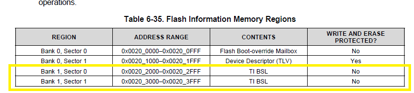

    The BSL scripter only works with the MSP432 BSL and it resides from address 0x00202000 to 0x00203FFF.
    Is this where you are trying to flash your boot loader??

    The BSL is called by the ROM Bootcode when the application memory is erased. The ROM Bootcode reads out addresses 0x0 and 0x4 from the application flash memory and compares it with 0xFFFFFFFF to determine whether or not the application memory is erased.
