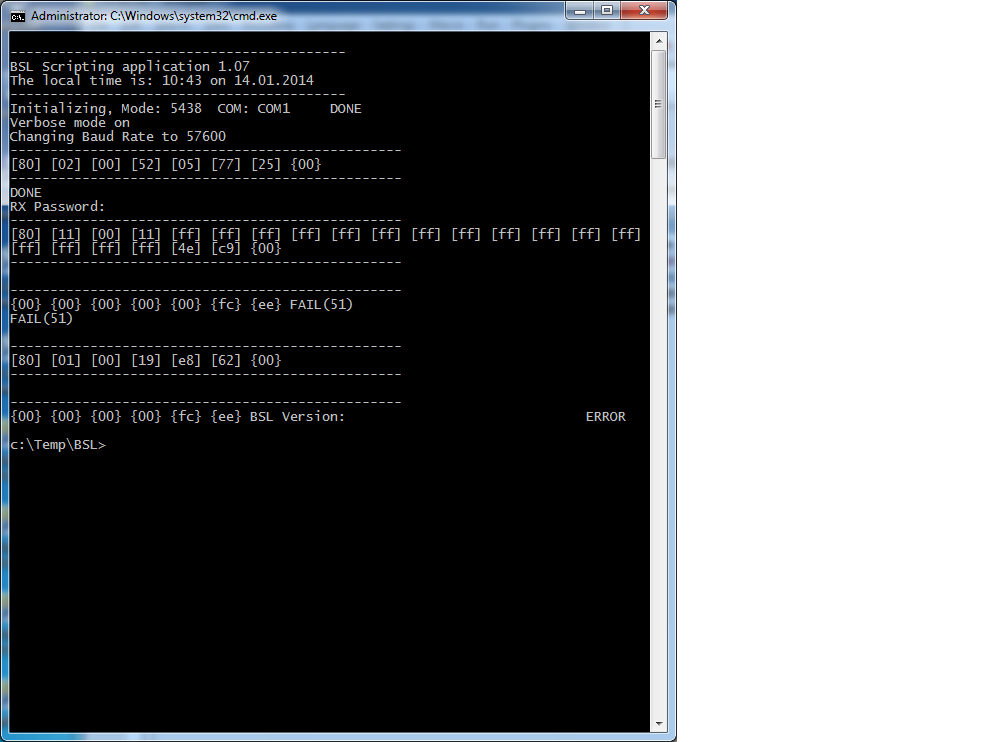

I'm working with MSP430F5435 installed at TMDSEVM6678L board. I'd like to program my own application into MSP430 using BSL as it's noted in slau319g user's guide. I'm using BSL Scripter v.107 and my own interface board to connect PC COM port to MSP430. MSP430 enters BSL, accepts commands with ACK byte, but BSL core doesn't respond as I expected (chapter 3.7 of slau319g user's guide). The following screenshots illustrate the problem.

    My own interface board which is used to connect PC COM port to MSP430 is only a converter board from 3V LVTTL to RS232 interface voltage levels. So there is no additional delay in UART connection. And BSL password is set to default - but it does nothing!

    Yes, my interface is like TI BSL schematics in slau319. I've checked BSL entry sequence carefully - it's like Figure 1-2 in slau319. Any other suggestions?

  • I've found out the problem - BSL_Scripter.
    1. In function invokeBSL() should be
        SetRSTpin(0);  /* RST  pin: GND */
        SetTESTpin(0); /* TEST pin: GND */   delay(10);
        SetTESTpin(1); /* TEST pin: Vcc */   delay(10);
        SetRSTpin (1); /* RST  pin: Vcc */   delay(10);
    instead of
    2. In function SetRSTpin() should be
      comDCB.fDtrControl = level ? DTR_CONTROL_DISABLE : DTR_CONTROL_ENABLE;
    instead of
      comDCB.fDtrControl = level ? DTR_CONTROL_ENABLE : DTR_CONTROL_DISABLE;
    I've fixed it and everything was OK.

    I don't use USB-UART bridge, I use direct connection from PC COM port to MSP430. The problem was in BSL_Scripter v.1.07 as I prevously described.

    However, at least your second screenshot seems to indicate that you get the BSL started. Now it doesn't react as expected. How did you connect your MSP to the COM port? I mean, electrically. The MSP uses TTL signal levels while the COM port uses RS232 signal levels, which are different and incompatible. You'll need a signal translator such as the MAX3232.
  • Dear Jens-Michael Gross!
    I'm using ADM3310 IC as signal translator from PC COM to MSP430 pins. All signals are connected without any inverters.
    As I previously wrote, I did connect to MSP430 BSL and successfully upload my application to it. The problem was BSL_Scripter application v.1.07, which I used to connect to MSP430. I've edited BSL_Scripter source code and got the correct result.
