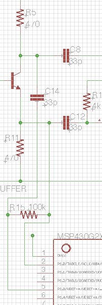

I want to use the comparator (of an MSP430G2553) to square-up a 200mV signal at up to 3.8MHz in a frequency-locked loop oscillator. This would require toggling at close to the maximum speed to drive the counter). Before I try it, any thoughts on whether it would work? Otherwise I'll need an external Schmitt trigger to square up the waveform.

    Well, you could use the comparator to get a square wave output, then re-route this output into a timer for counting. And do your FLL work with a capture result from a reference, at a much lower frequency. This could work. The comparator response time is 120ns. Which could be enough for your 3.8MHz signal.
    A problem could be the reference for the comparator. The internal reference nodes are much too high for your use. You'll need ~0.1V for your 0.2V signal. So you'll need an external reference for comparison.
  • I have a differential signal of 0.2V P-P which I can feed into the comparator + and - inputs (capacitively coupled so it can be DC adjusted wherever suits), which should square it up. I thought it was possible to feed that in to the counter register of TimerA, as you describe, and set an interrupt when the counter passes zero, when I can look at my wall-clock and compute the frequency. No CPU interaction should be necessary for the counter to count. Am I wrong in thinking that the comparator output can be used that way?
    Just don't float inputs. You need to "center" both inputs between VCC and GND using resistors.

    Yes, everything sounds good. - If you follow advice of JMG to feed comparator output into timer INCLK as external clock. Then you just CCR- capture timer using reference clock and you got frequency counter :)

    Exactly - as I said, "so it can be DC adjusted", as in the attached fragment (the phase splitter is also running on 3.2v).
    I was already confident that the counter is fast enough - but wasn't sure from the data sheet that the comparator would be. With your re-assurance, I'll try it and see,
