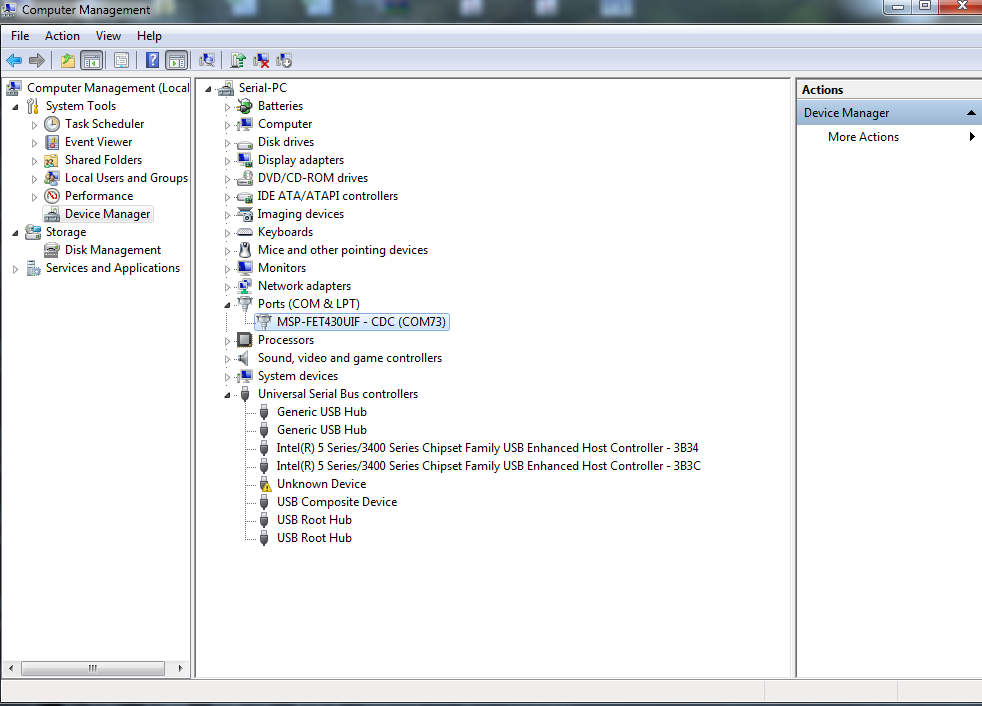

i am using MSP-FEt430UIF  V1.4a , but now only green LED is glowing and its detected in device manager as MSP430FEt  CDC but i followed all steps to upgrade or downgrade but in elptronic it says com port issue. please help me to resolve this issue.

  • HI Jens,
    thanks for the reply, please find the snap shots of elptronic and device manager , i have tried to change the comport but nothing works out.
  • The FETs used to use a VCP (Virtual COM Port) driver, but newer drivers use a CDC structure that forwards to a VCP. After the update, the PC will assign a different COM port for the new VCP and somehow this has been messed-up. In fact, sometimes, Windows will assign the same COM number to multiple devices (of course this won't work properly) or fail to report the available COMs (especially if they have number >15) to the applications. This is because of multiple APIs to access COM ports, starting with old DOS.
    YOu can try to manually assign a COM port in device manager and then restart the software and re-configure the COM port to use (or leave the setting to auto, if available)
