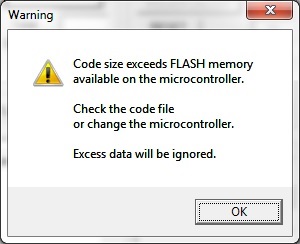

Regarding recovery of the default BSL image, you can find the copy in the SLAA450 associated files:
http://software-dl.ti.com/msp430/msp430_public_sw/mcu/msp430/CustomBSL/latest/index_FDS.html
You can download it using MSP430Flasher or Elprotronic Pro430 Lite:
but make sure the access is enabled, since the BSL Flash is per default protected:
