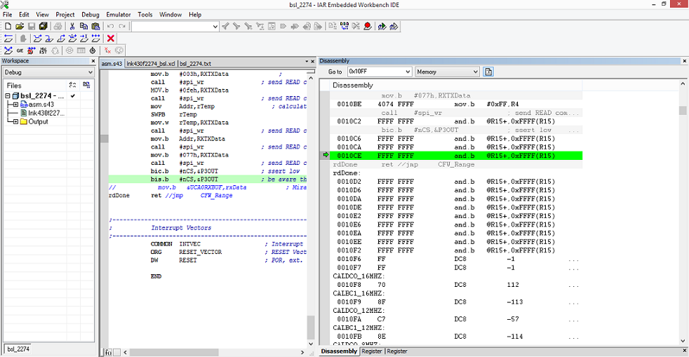

  • Hi Luis,
    I've been trying to change the BSL, for receive data form a SPI memory (at25f1024), but alwasy jump to the main, when I look the desassembly program, it works just to the addres 0x10C0, I guess that is because the SPI comunication uses a lot of call function.
    I'm using the msp430f2274.
    I will send you the program, please any advice wold be very helpfull.

  • Hi Luis,
    I can  debug, but when the program reaches the 10CEE address  , go to main, in other ocasion  the jump address was 10C00, in the image you can see better. From the green colored line goes to main.
    I modified the linker file, similar as you share in the file above, is practically similar to the example in slaa450, because the size of the information memory is the same.

  • Hi Andres,
    From the screenshot, I can see that info-A is not being erased/written. Your .txt has code in this area, but you have 0xFFs which means that IAR is not writing this area.
    Try Options->FET Debugger->Download->Allow erase/write access to locked flash memory
    And Options->FET Debugger->Download->Erase main and Information memory
