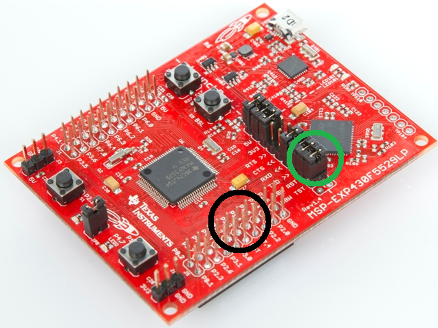

im using the new launchpad (exp430f5529LP) to program a g2553 in circuit. ive connected the rst and tst lines as well as Vcc and gnd and a 47k resistor from rst to vcc
I keep getting "MSP430: Error connecting to the target: Unknown device" error when programming

    Is the 2n2-filter-cap assembled from RST to GND, too? Your wiring should be as short as possible. And maybe a silly question, but where did you connect the SBW-wires? On the EXP430G2 you can remove the micro, but on the EXP430F5529LP you cannot. So did you make the connection from one of the two header-connectors on the side of the board or did you make it from the header that holds the jumpers?
    Of course you have to establish the connection from the green-circled ones without the jumpers connected.

  • The datasheet for the launchpad specifies that it can program devices other than the one on the board. Also, yes I have disconnected all the jumpers and am connecting my g2553 to the pins on the emulator side of the board. I have not connected the 2.2nF cap but have never had to in the past. I will give it a shot later today.
  • For the programming process, the 2.2nF are not necessary. The FET is pulling RST lien up and down. The cap is required for proper startup when RST is NOT connected to a FET (it provides a delay between rising VCC and rising of RST), and of course suppresses spikes by crosstalk to the RST line.
