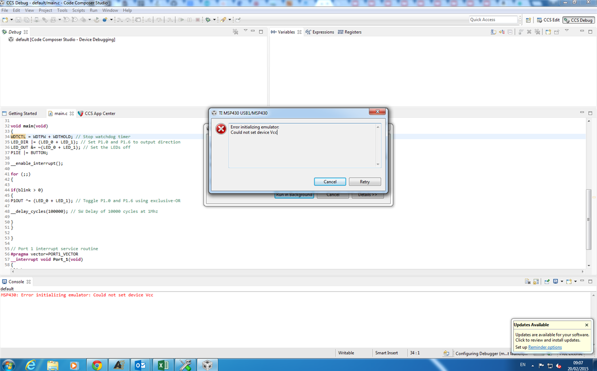

I am new to this and I have recently built a custom EzFET Lite board but am having problems when going to program using code composer. Board will program a MSP430G2553 when using IAR embedded workbench but will not program at all with code composer or in linux. It come up with an error that it could not set device VCC. Attached is a print screen of the error and the schematic. Have you any suggestions. What software package do you recommend to upload firmware to the programmer and what firmware should be uploaded. This should tell me if i am uploading the firmware correctly.
