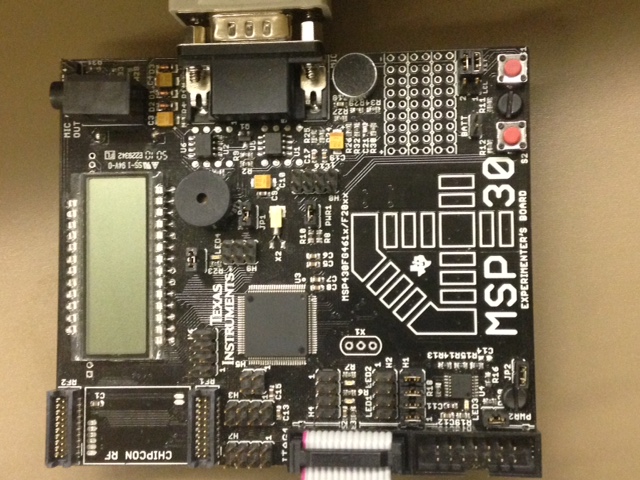

  • I have been trying to get this resolved for a couple of weeks now and being very new (i'm a student) I do not always understand what is being said so please forgive me for my ignorance.
    I have a C program that I wrote for school. I demonstrated it at school on an MSP430FG4618/F2013 target board just like what I have. My program uses ACLK for timing purposes to operate the buzzer. It works at school but not for me at home on my board. My PC's COM port is set the same as school. My target board is the same. Only difference is the EMULATOR. I have the new MSP-FET and we use the old MSP-FET430UIF at school.
    The program should not have to be modified because of the different emulator should it? If so that means I have to change it every time that I want to work at home and when I go to school. All I wanted to be able to do is work on it at home and demonstrate at school.
    I really really could use an answer in the simplest of terms if possible due to my short comings.
    Input is greatly appreciated!
  • Now you are changing subject, you have already a couple of thread’s with this question open. Continue with one of these, but in the mean time you can check if you power-up your board correctly, battery or AC-mains with the proper jumper settings, and not powered by FET.

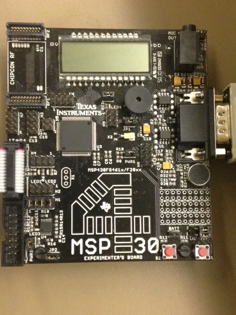

  • Why not FET? That is how its powered at school. Here is a picture of the target board  .
    Here is my C code. This works at school.
    Can you clarify what doesn't work?
    E.g. does the buzzer not sound, sound at the wrong frequency, or something else?
    And that’s exactly the difference with your school! Maybe the new FET gives for some reason a too low voltage for the buzzer. Why not try that?
  • Buzzer does not sound. Let me also mention that based on the code above an LED is to blink 1/2 sec on 1/2 sec off. It does blink but slower than 1/2 sec on 1/2 sec off.
  • Can you clarify on what to try? Where should power come from? I put the batteries in and changed the jumpers and get same result. NO BUZZER SOUND AT ALL.
  • As I know the buzzer must have a frequency of ~2.4KHz. Try with “TB0CCR0 = 7;”.
  • Still nothing.  I did get a sound from the buzzer using the SMCLK. Found this just to test buzzer. I need ACLK to work though.
