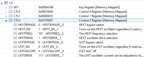

I am simply running the software example cs_hfxt_start.c, and I'm getting something fairly less than 48MHz. I decided to check on the datasheet, and this is found in the CS - CTL2 register value, from running that very code
As we can see, the HFXTFREQ value is 101, which according to the datasheet, means a 32Mhz-40Mhz range, where it should be 110, indicating >40MHz.
Is there anything I can do to get around this?

    do you just assume that the clock is wrong based on the register settings or did you measure the HSMCLK at P4.4?
    There is
    • msp432p401_cs_03                              Device configuration for operation @ MCLK = DCO = 48MHz
    in the code examples
    http://www.ti.com/lit/zip/slac698
    which runs the device at 48MHz. This example works, so you could have a look at the register settings when using it.

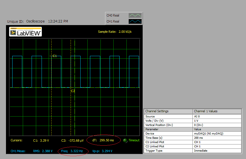

    In the figure shown bellow, we can see the output from P1.0 (LED 1.0) for the cs_hfxt_start.c from MSPWare code example.
    Notice that P1.0 from P1 toggles every 0.3 seconds, when in fact it should toggles every 0.5 seconds.
  • Are you sure you don't get fooled by your scope? You are sampling with 2ksps. Is the scope's bandwidth large enought to sample this signal?
    Your sampling frequency needs to be at least twice the sine frequency of your input signal.
    And as an additional rule of thumb for a digital scope: The sampling rate should be four times larger than it's bandwidth.

    I don't have access right now to an oscilloscope and my university is closed for the holiday. But I did another test, but now, using DCO as source clock input for MCLK and then I realized that the problem is still occurring for certain clock speed threshold. In all tests, I kept configuring the SysTick interruption for toggles the LED every 0.5 seconds. The desired result were obtained when the source clock speed falls below a certain threshold. Then, I discovered that the problem isn't the clock system, but the SysTick Period. In the example code provided by Texas MSPWare for HFXT (48MHz) the SysTick period is configured as follows:
    MAP_SysTick_setPeriod(24000000);
    But, the Driver Library Manual indicates that the period value range accepted is between 1 up to 16, 777, 216. I believe this explains why the cc_lfxt_start.c worked fine (MAP_SysTick_setPeriod(16000)) and cc_hfxt_start.c didn't.
    Apparently I just fooled by the sample code from MSPWare. Although this is not critical, it could be fixed in the next release, but I don't know how inform the developers team.
