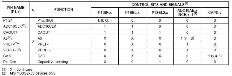

  • Russel,
    good to hear that it works now, but the way you are doing it isn't a good one in general. At least if your program will grow and therefore has to do more tasks. Never use a while()-loop inside an interrupt - try to avoid it in all cases...during the initialization before the main program starts this might be OK. So I would recommend to configure the ADC at startup and then only set the ADC10SC bit in the timer-interrupt. No need to set and reset ENC since you are not changing the configuration of the ADC. And no need to disable the ADC everytime, unless you want to save as much power as possible. But doing so isn't a problem, of course. Then use the ADC's interrupt and wait for it to fire and fetch the ADC result in it. The small portion of code to set/reset the output pin can be done in the interrupt, too.
    And here is a critical thing in your code:
    // Set Timer A Counter Interrupt Enable
    TACTL |= TAIE;
    The TAIE interrupt is located in
    #pragma vector = TIMER0_A1_VECTOR
    so you do not have an interrupt vector for it. This can cause your program to crash.
    What I'm also wondering about is that you do not set any ADC10AE bit for your input - you should not get any correct value since P1.3 isn't configured to be an analog input. Furthermore this statement
    // Enable peripheral module on P1.3
    P1SEL |= P1_3_VOLTAGE_LVL;
    is no valid configuration of P1.3 - when you set P1SEL in combination with P1DIR then you can select the ADC10CLK output function. Or setting P1SEL in combination with P1SEL2 and P1DIR will select the CAOUT function. But only setting P1SEL is nothing:
    For using P1.3 as an analog input, the PSEL bits are don't care.
    Dennis
