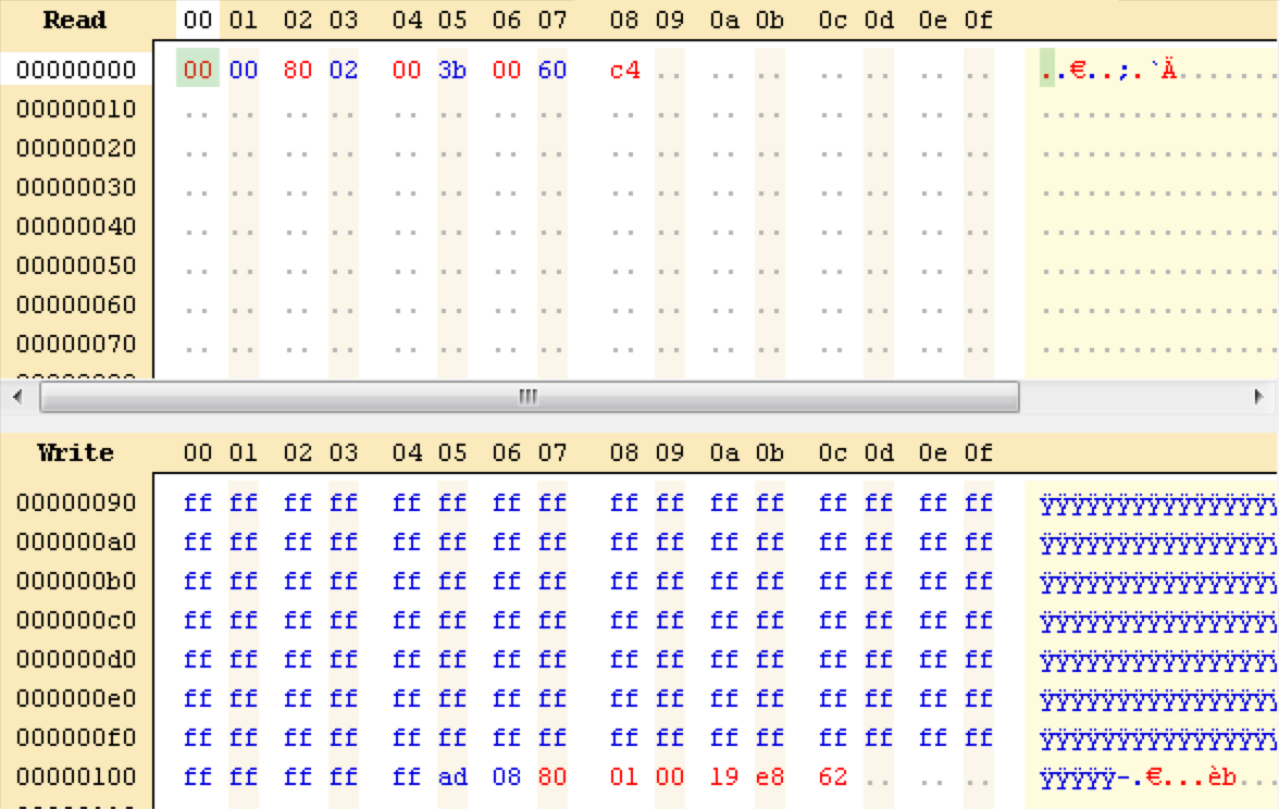

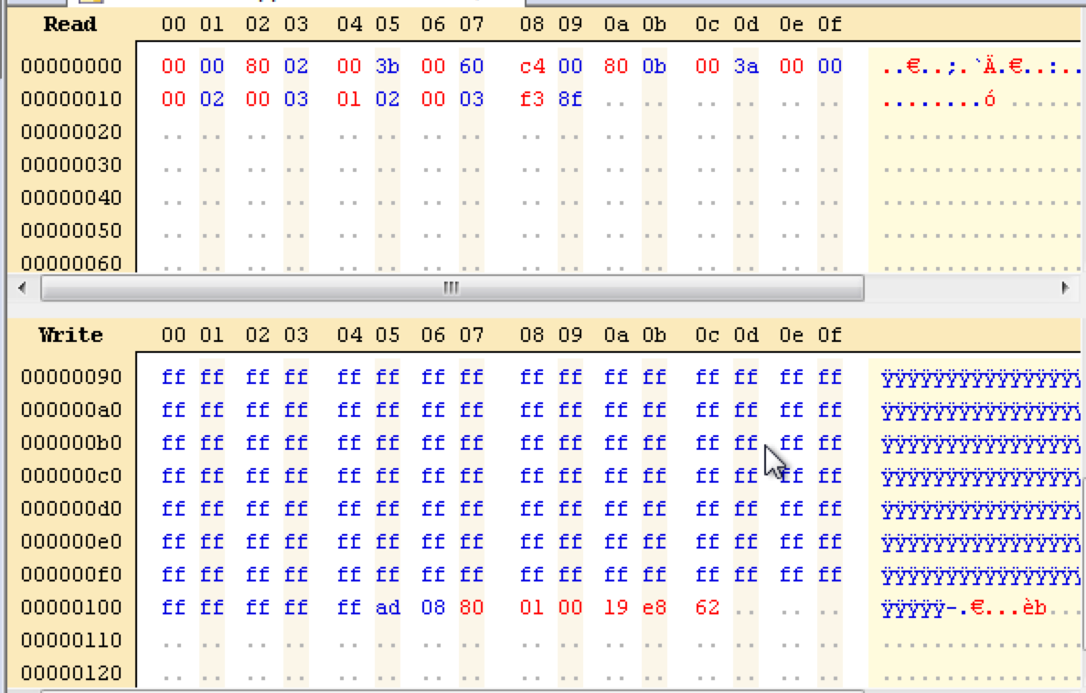

    There seem to be some problems with CCS downloading to BSL area.
    I also tried using UniFlash with the same results.
    However, I tried with IAR and it worked OK.
    I shows the steps in the attached document:
    Downloading BSL.docx
    I realize that this is not the best solution and we need to fix it in CCS, so I'll work with the tools team to fix it.

  • Hey Luis,
    after following your steps, I was able to flash the BSL and a first check of the memory view seems to be fine. Thanks!
    But what is about the Flash Mailbox section? Does it make sense to write for example the start byte by myself
    and hope that the BSL will start after correct self-setting of the memory?
    Thanks in advance and regards

    After rereading your Word document I noticed that my .txt-File from MSP432BSL_1_00_00_00 seems to be exactly the same as your memory browser view in CCS, which was a kind of wrong. At least first 32 bytes matches. So i guess you have compiled your own version of BSL and getting other binaries hence. As I said before the currently available source code could not be compiled due to several compiler errors. Can you provide your probably modified version of BSL? I could add some debug outputs then and try to figure out, whats wrong.
    Thanks and regards

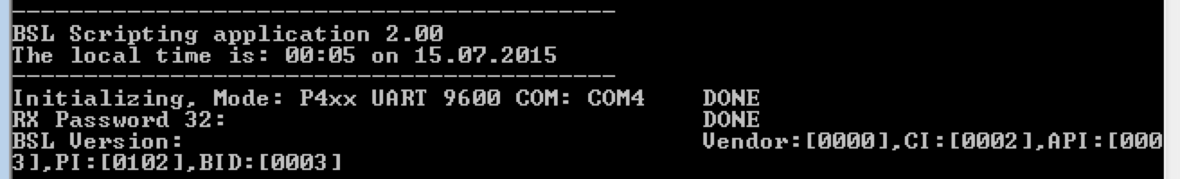

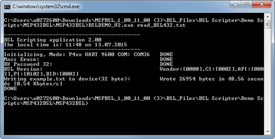

    Oh, that screenshots just shows an image that I downloaded to overwrite the default BSL.
    However, I tried re-downloading the default BSL (BSL_0000.0002.0003.0102.0003.txt) and I think I was able to replicate your same problem when using BSL Scripter 2.01.
    I then tried BSL Scripter 2.00 and it worked fine with the following script:
    MODE P4xx UART COM36
    MASS_ERASE
    RX_PASSWORD_32
    TX_BSL_VERSION_32
    Can you try it on your side?

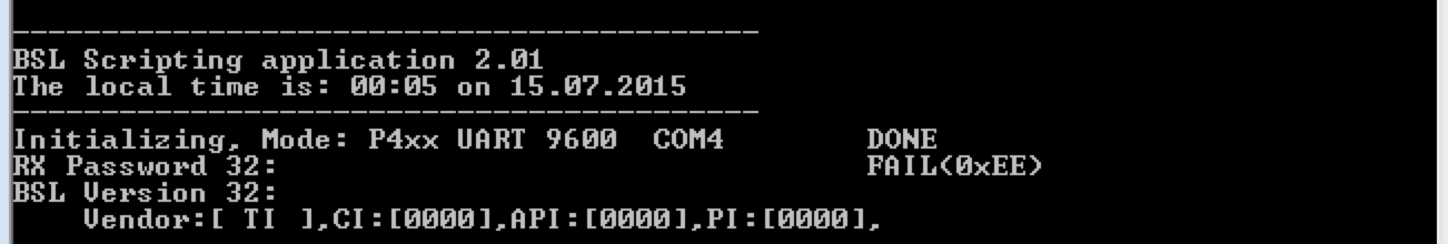

    But back to topic: I'm sure, that Hardware Invocation of the BSL is not doing what I expect. I have to take a closer look when I got some time for it. (I have rechecked my Mailbox settings and get an ACK (0xACE) for the BSL Hardware Invocation area in the flash memory (inspected with CCS). But pressing the button or not during reset has no influence on the starting of my own firmware. Changed it for tests to light up RGB LED instead of small red one, because I think BSL uses it (?), but everytime the RGB LED is on...)
    Because I had no fast idea of fixing the BSL Hardware Invocation problem, I have used Software Invocation for now. And yes, you are right. When using BSLScripter 2.00 I get:
    But when using BSLScripter 2.01 I get:
    I also captured, what is the difference between both on the UART interface. BSLScripter 2.00:
    And BSLScripter 2.01:
    Seems to be a timing problem for me, because the data send by BSLScripter is the same, but there is no resynchronisation answer by the BSL itself.

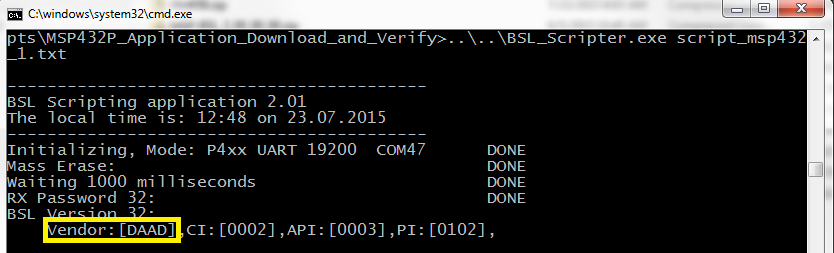

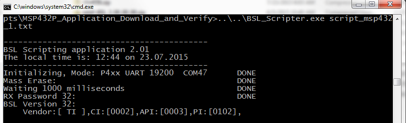

     Using BSL Scripter v2.01, Could you please change the speed to 19200??
    Also at the same time, I was able to re-build and test the BSL project using CCS v6.1.0.
    As example I changed the Vendor to 0xDAAD. If you are still interested you can find the project here:

  • Dear Luis,
    Please help me understand entering the BSL on the MSP432. I've had success on other micros such the FR5969 and F5438A but on the ARM version I'm following SLAU622 "BSL User's Guide" page 16 (Figure 6).
    I'm using the Launch pad and I press the RSTn (switch S3 and thereby grounding it) pulling P1.0 High, then releasing RSTn switch. The Launchpad should go into BSL but does not. This is all per Figure 6 diagram.
    I am using BSL scripter tool (bsl-scripter-windows.exe) version:
    BSL Scripter 3.1.0.0
    PC software for BSL programming
    2016-May-30 21:49:41
    ...and sending
    MODE P4xx UART 9600 COM4
    VERBOSE
    TX_BSL_VERSION_32
    in my script file. The BSL scripter tool times out and does not seem to work. Can I get the Launchpad to go into BSL mode doing what I'm doing? Is Figure 6 on page 16 of SLAU622 manual correct?
    Thanks.
    -Jim
  • Hi Jim,
     By default the hardware-based BSL invocation is not enabled. To enable it please take a look a this thread (you will have to enable it using the flash mailbox) e2e.ti.com/.../1779629
    Yes, but your flash will need to be erased, please take a look at section 4.3 BSL Invocation (SLAU622). The easiest way to erase your flash is thru the Factory Reset as described in http://www.ti.com/lit/pdf/slau575 chapter 8.
    Hopefully this helps.
     David
