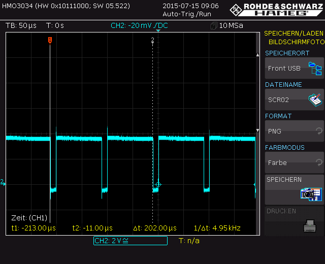

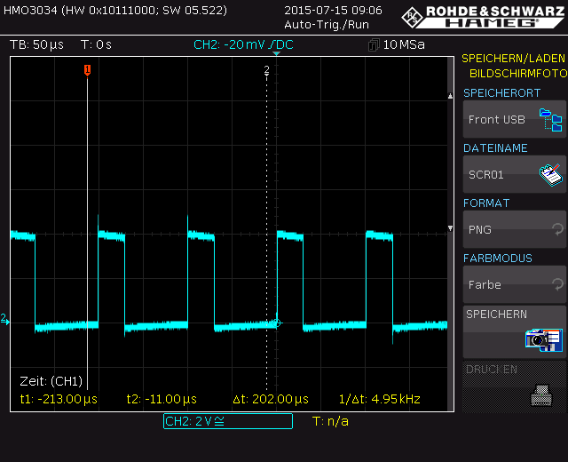

    Look at these oscilloscope files:
    This is CCR0 == 100 and CCR1 == 30
    This is CCR0 == 100 and CCR1 == 90
    This is CCR0 == 100 and CCR1 == 100 (look at the little low-pulse)
    This is CCR0 == 100 and CCR1 == 100 with a magnification of the small low-pulse - it is exactly 1µs == 1 TA1CLK cycle == 1 SMCLK cycle @ 1MHz
    This is CCR0 == 100 and CCR1 == 101 and you can see that now everything is high because CCR1 > CCR0
    This is CCR0 == 100 and CCR1 == 0 which leads to everything beeing low

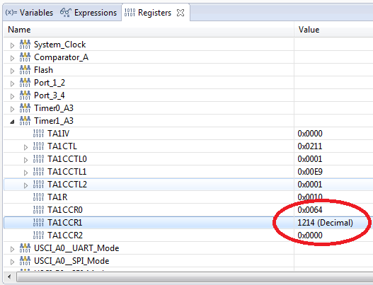

    And here is the result for a single click on the button:
    As you can see, the short button press caused the variable cycle_counter to be incremented 6670 times which means, your CCR1 was incremented by (6670 * 10). When beginning from 50 we would expect it to be (50 + 66700) == 66750 now, but this extends the range of a normal 16 bit unsigned integer, so what will it be now? It is simple: (66750 - 65535) == 1214
    Let's look at CCR1:
    There it is.
    So you should now start to write some code to detect a single button press, even if the user holds the button down. You could add some sort of repeat functionality for an ongoing press, like adding +10 every 200 ms. But this is up to you.
