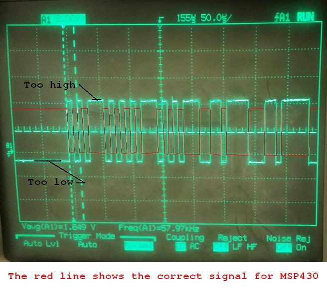

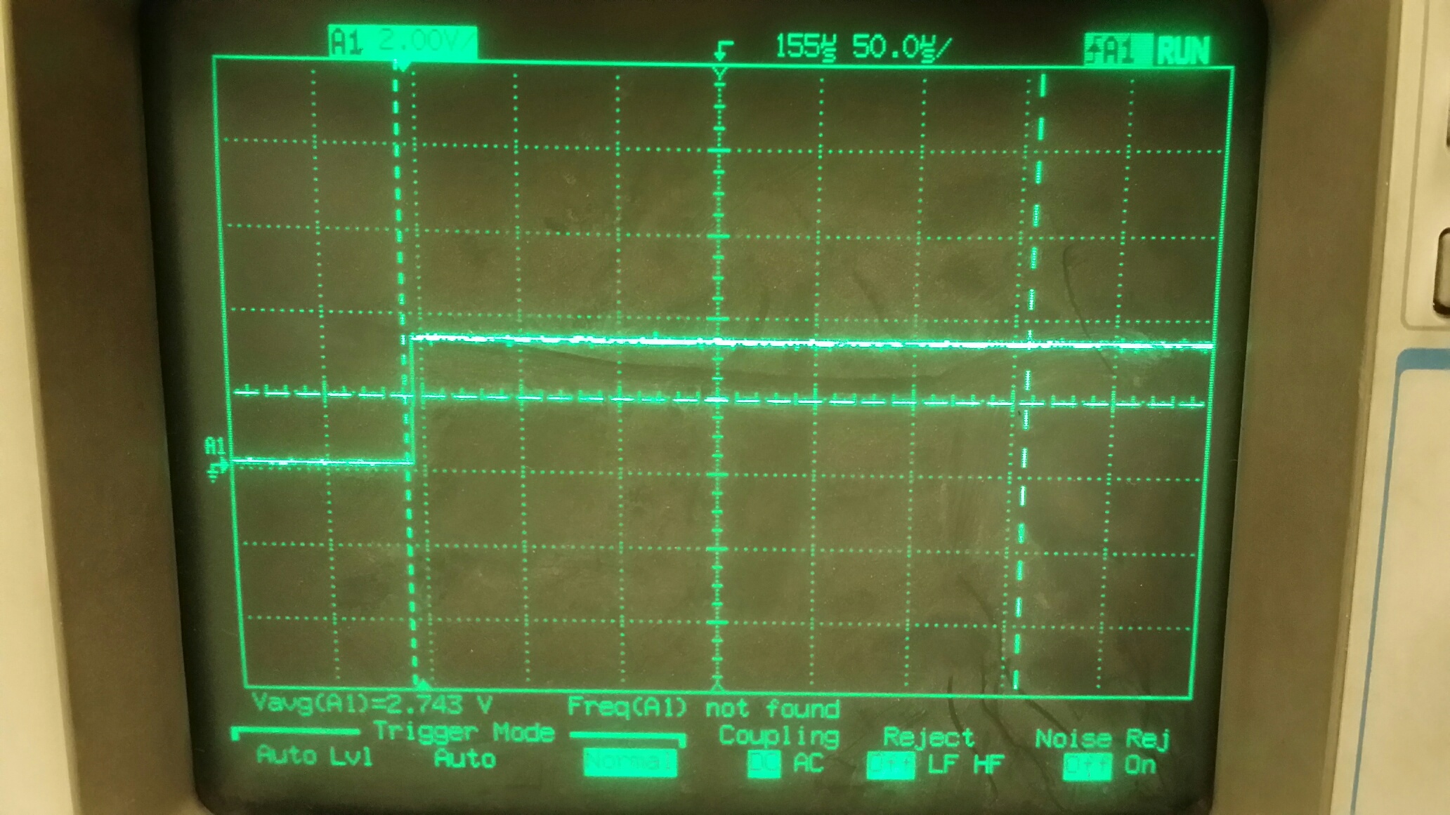

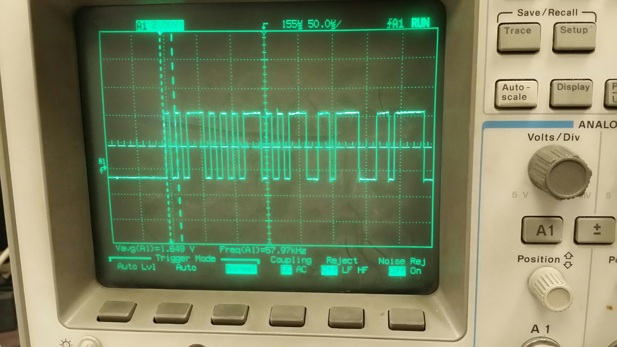

I think I have everything set correctly, yet when I send characters from a SI Labs CP2104-EK (USB to Serial converter)  to my 5438 no interrupt is generated. I am using RealTerm for sending from the PC, so I can vary the baud rate and how the data gets sent.
This is what I send from the USB converter.
This is what I get back from the 5438, yet there is no interrupt.

    I then start up my external GUI that is sending EE1A15C3 and expecting a response from the MSP.
    UART A0 does respond but there is no interrupt for UART A3.
    If I halt the IAR I will get  errors on UCBRK and  UCOE . and the UCA3RXBUF = 0x00, but no interrupt

  • MSP430 in/out signals are 0 to 3.6V. Looks like you are feeding it with RS232 signals. Not only the voltages are too high and too low, the "polarity" is also wrong.
