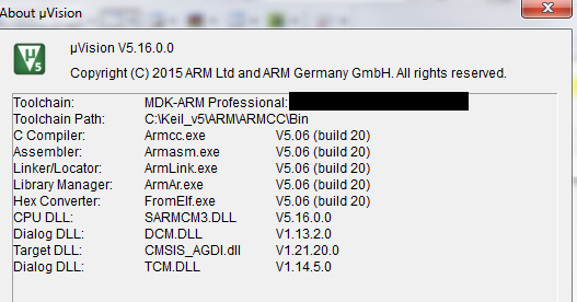

    How slow?? Just trying to get a feeling on how long does it takes to jump into the function...
    Which µVision IDE version is your customer using?? I'm not experiencing this slow - behavior and it may be related to the target dll. I'm using v5.16.0.0

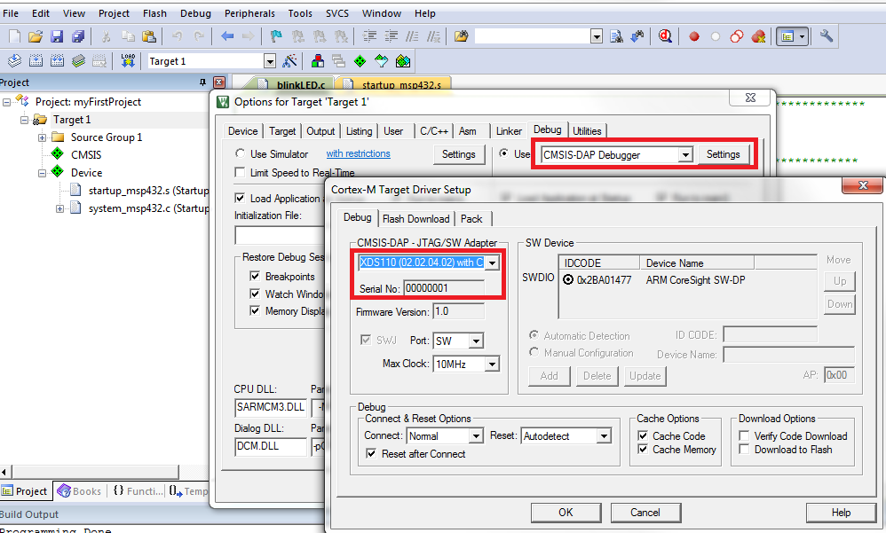

    Yes they can. They will need to have different serial number on each of their launchpads, This will allow them to have more than one XDS110 connected to their system and let the host locate a specific one to connect to.
    They will need to run the following two commands:
    xdsdfu -m
    xdsdfu -s xxxxxxxx -r
    where xxxxxxxx is a serial number, any combination of letters and numbers, from 1 to 8 characters in length.
    You can find the xdsdfu utility in your ccs installation - C:\ti\ccs_base\common\uscif\xds110 and then in your project you can select which debugger to use:
      David

    Regarding to the multi debugging of MSP432 LP, I tried to flash the serial number. As a result, we could write the number. But there was not the folder of "XDS110" which you pointed out on your previous post. I find this on following location.
    C:\ti\ccsv6\ccs_base\common\uscif\xds110
    In case of using ARM-MDK, would you please show us the "xds110" directory?
    **It seems that customer should also install the CCS because this directory is in CCS.

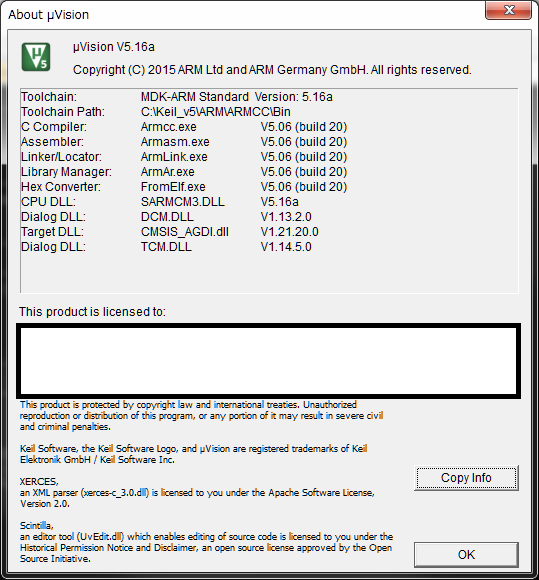

  • Hi David,
    I got feedback from my customer. Please see the attached file as below.
    And I got feedback about Debugger. The competitor's debugger is LPC-Link2(NXP) in my previous post.
    If you have any addition questions, please let me know.
    Best regards.
    Kaka
