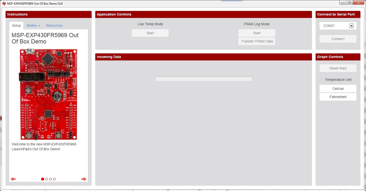

I recently got a MSP-EXP430FR5969 launchpad and when I started to test the out of the box demo, there seems to be some issue.
First, the temperature values read out by the device are in the range of 85-90 degrees centigrade.
Second, although MSP430FR5969 could log the data into the FRAM (confirmed by verifying the operation of LEDs), I couldn't print the data back to my computer.
I don't think backchannel UART is at fault because it could show the readings in the live mode. Furthermore, I could run the basic "Hello_world" program, through which I could display "Hello World!" on the screen. So, I'm assuming micro-controller is also working properly.
Please help me know why my evaluation board is behaving oddly.

Thanks for the patience! For now we have a small work around that you can implement. Replacing the 2 attached files in the OOB project should fix to the issue.
Basically, the PC GUI (using a serial-port JavaScript library) expects a certain arbitrary delay between small chunks of UART data transmissions. The delay in the original code somehow is not long enough for the GUI to separate the incoming data.
We do wish to improve the UART communication to combine small chunks of UART data into larger data blocks, but that will be have to wait until a future MSPWare update.
