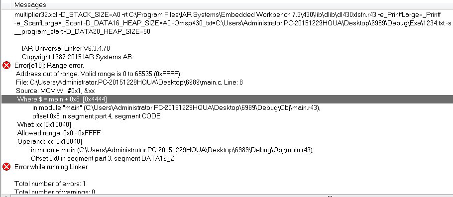

It has nothing to do with the code. It's about how to modify the .XCL file(IAR for MSP430) to make a FRAM space above 0xFFFF for RAM usage.
Here I paste the screenshot of the error /code and the XCL file.
#include "msp430fr6989.h" unsigned int xx[100]; void main( void ) { // Stop watchdog timer to prevent time out reset WDTCTL = WDTPW + WDTHOLD; xx[0] =1; while(1); }

Hello David,
Yes, put a variable locate@ address > 0xFFFF is OK . But if I want to use a space for example 0x10040~ 0x23FFF as stack, the IDE will tell error.
I changed the linker file:
// ----------------------------------------------- // RAM memory // -Z(DATA)TINYRAM=0006-001F -Z(DATA)DATA16_I,DATA16_Z,DATA16_N,TLS16_I=10040-23FFF //-Z(DATA)DATA16_I,DATA16_Z,DATA16_N,TLS16_I=1C00-23FF -Z(DATA)CODE_I -Z(DATA)DATA20_I,DATA20_Z,DATA20_N -Z(DATA)CSTACK+_STACK_SIZE#
It seems like STACK must located @SRAM or FRAM smaller than 0xFFFF or IAR will think it is illegal.

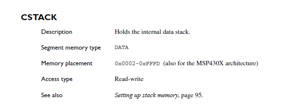

Hi SeaFesse,
I do not think it is possible to put the stack above 64KB (even that the SP register is 20bit wide).
I tried changing the cstart without any luck, it builds but the SP does not reflect the correct address
MOVA #SFE(CSTACK), SP
or
MOVA #0x14000, SP
So I looked in the IAR C/C++ Compiler User Guide for MSP430 and:
Anyway I'm looping in the MSP430 Compiler Team as they would have the most expertise regarding this question
David
init: MOV #SFE(CSTACK), SP ; set up stack main: NOP ; main program MOV.W #WDTPW+WDTHOLD,&WDTCTL ; Stop watchdog timer MOVA #0x10040,SP
Please also add the address space to xcl file for Read/write data in FRAM space.
// --------------------------- // Read/write data in FRAM // -Z(CONST)DATA16_P,DATA20_P=4400-FF7F,10040-23FFF -Z(DATA)DATA16_HEAP+_DATA16_HEAP_SIZE -Z(DATA)DATA20_HEAP+_DATA20_HEAP_SIZE
